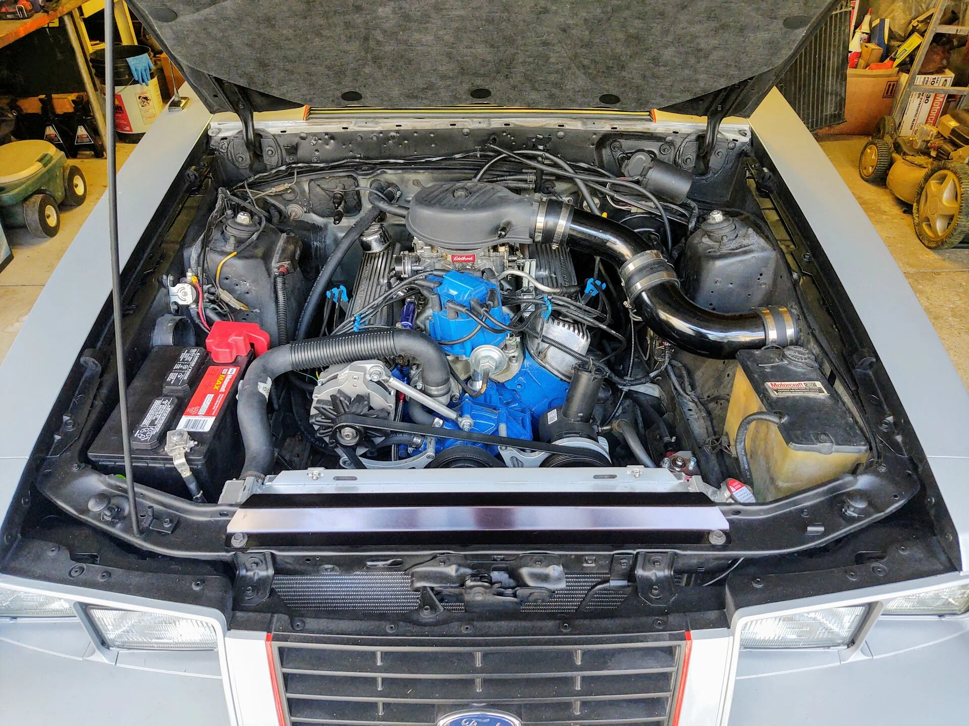

One of the biggest problems I have seen is to much fuel pressure at the carb. I run an Edelbrock carb and any pressure over 5 psi will push passed the seats and run rich. Factory manual pumps make around 9 psi and you must use a fuel pressure regulator to keep the pressure down. On a car that was fuel injected if your using the electric in tank pump the pressure can be 35-40 psi and after running for a bit the carb will look like a fountain spraying fuel out the top. Just something to check. Another question is what distributor are you running?
I just bought a regulator and a pressure gauge to test it. Butttttt I decided to look over specs of how basic tuning of the carb should be. My fathers been helping me out on this but he gets ahead of himself and starts tuning things with out adjusting the rest and says go for it. Sooo I got everything set to a normal tuning and I earlyr today I had noticed the primary jets were not spraying at all. So I adjust the floats cuz the primary was basically empty. Along with adjusting air flow ratio a bit I got the primary’s to spray again but that primary bowl keeps emptying out and not filling back up.

This really does not sound like a carb unless the choke is shutting when hot. That’s easy to check when you are waiting for it to cool off. A carb problem will more likely be there at start up or all the time. The filter fits the issues better, as does ignition components.
My hesitation in diagnosing it more specifically comes down to not knowing if your car is a stock, factory carb engine, a modified carb car, or a former EFI car.
When I put info from the two sites together, it looks like the carved, 210 Hp engines came with manual transmissions, and the EFI came with automatic. So what transmission do you have? That will help with the electrical side of the diagnosis.
Then, what numbers are on the carb choke horn? A picture of the carb would help in ID. It is very easy for someone to haves replaced the stock one with a 1850-x model or a newer street heat to get rid of the backwards idle screws or simplify tuning. Does it still have the EGR spacer plate under the carb and valve pointing to the back of the engine?
