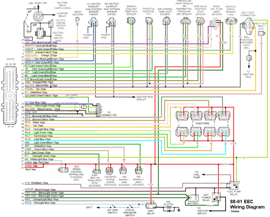

Diagram courtsey of Tmoss & Stang&2birds.
Remove the passenger side kick panel and disconnect the computer wiring harness from the computer. There is a 10 mm bolt that hold the connecter in place. See http://fordfuelinjection.com/index.php?p=74 for more help
Use a DVM or Ohmmeter to measure the resistance between pins 40 & 60 and the ground connection by the computer. You should see less than 1 ohm.
Measure the resistance between the Self Test Input red/white wire (pin 48) and ground with the computer disconnected. You should see more than 1 megohm. If you see less than 10 ohms you have a wire shorted to ground that has put the computer into self test mode without your help.
