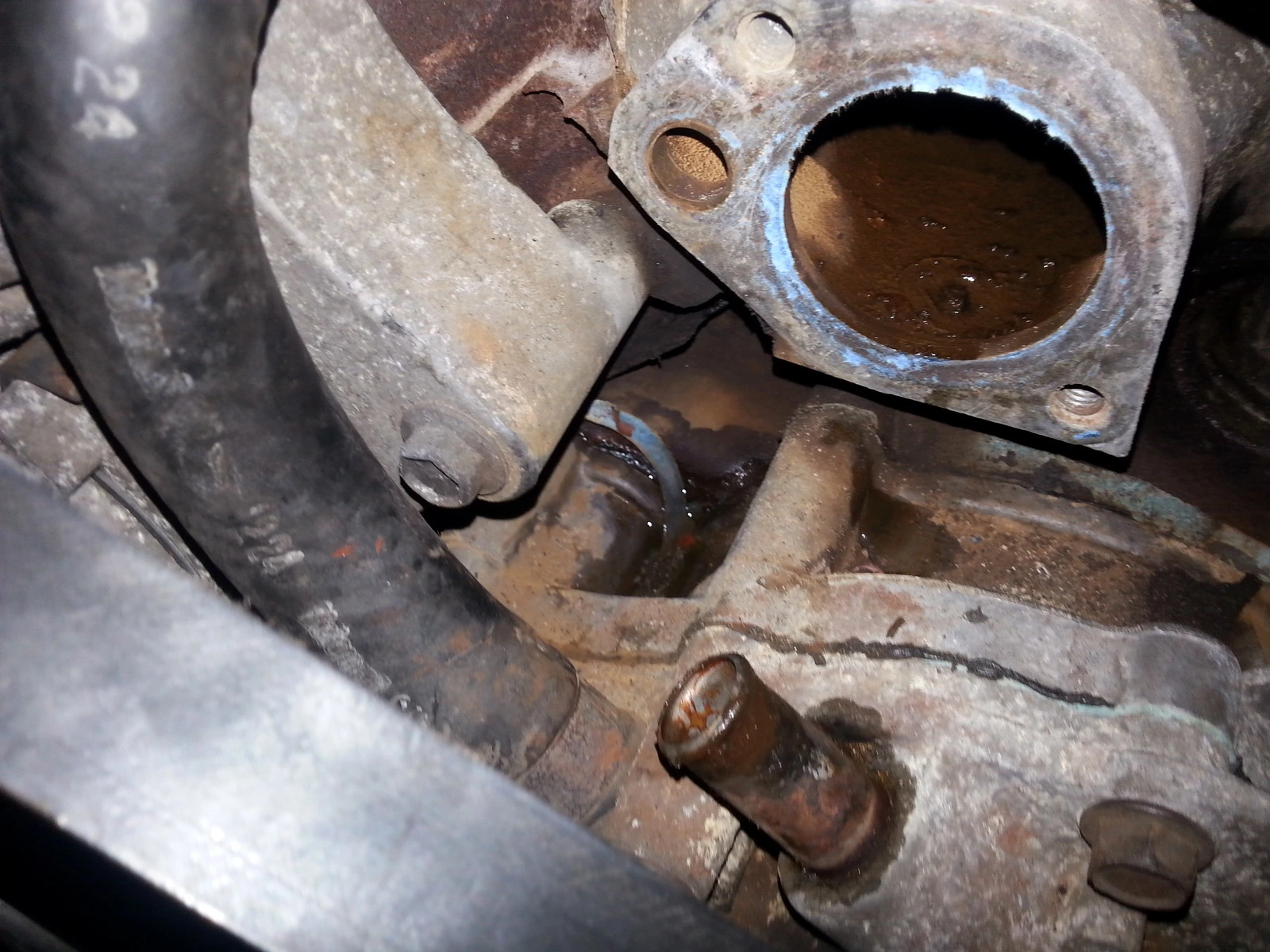

Yeh it verywell could be the head gasket at this point idk. I'm going to take it to my buddys shop and he's going to pressure test the rad. He wants 40 bucks just for that tho does that sound right? I looked online and I can a cheapo pressure tester for 30$...I'm sure his is much better though. He said something about a vacuum that sucks the coolant out and what not...just curious on that price. It kindof looks like there was a leak at some point by the water pump under and behind the thermostat housing I have a picture. Is the water pump attached to something else that bolts onto the block? That gasket might be bad.
