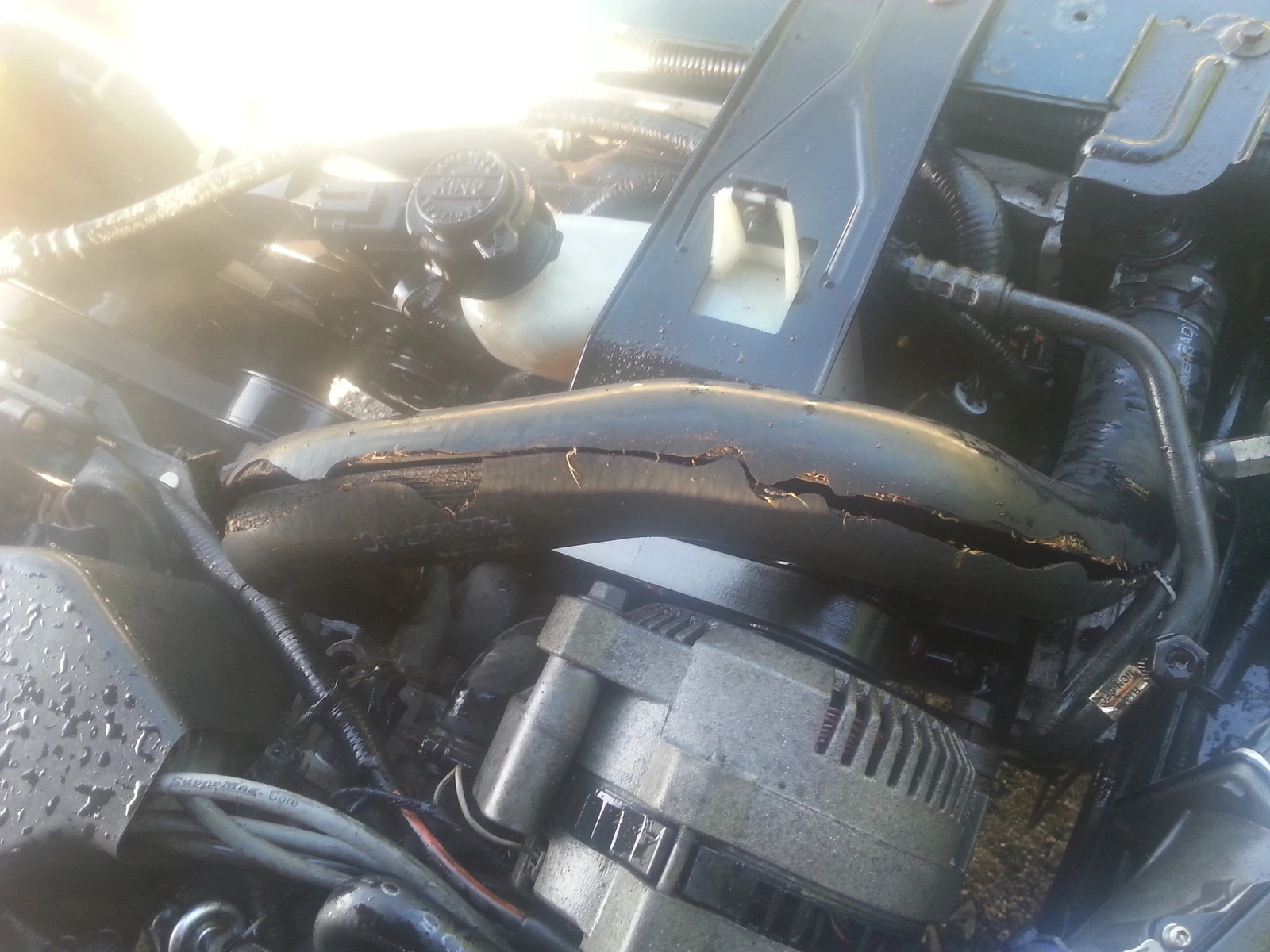

I had the car running for a half hour and drove it another 45 mins after I did all that so I don't think it will overheat and is way better the before....before the thermo, cap, hoses and new fluid I couldn't drive it more then 15-20 mins without it getting really hot at the L in the word normal on the gauge. Then two days ago I blew the hose to pieces complelty destroyed the hose even blew a hole in the cardboard thing on the inside of the hood lol. But I did notice that who ever changed the thermo last time put the damn thing in backwards wich I guess clogged the system over pressurized and blew the hose....if they couldn't install a thermostat right I'm begining to get worried what else did they try to fix thsmselves.....that's just dumb lol

That picture was just after my hose blew....and thebonly time I overheat was right before the hose above blew...it always stayed at the L in normal now it gets that hot but then back to about half way...I even put in a 180º thermo to keep the engine cooler
