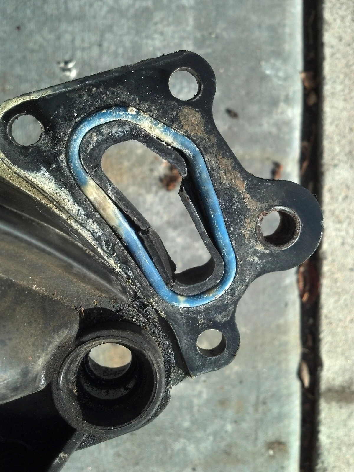

Intake is likely cracked if you see coolant in the wells, or you have a heater hose leaking. These cars had issues with the intakes cracking particularly around the front coolant crossover and the rear heater hose nipple. Ford eventually redesigned the intake with an aluminum coolant crossover but the rear nipple is still an issue. As far as the noise goes I would get that intake off, pull the cop boots and get that coolant out because it's likely causing a misfire. Buy a new one from Dorman or Ford Racing, your choice. Hopefully this is all your looking at and probley is but a bit of advice here would be maybe not burn out and lay on it so much.

My buddy helped me open up the intake aaaaand... it was cracked, IMG_20131123_142915_466.webp so after a compression test (which came out fine) some coolant splashing and a stop to pep boys; we slapped on a fresh intake and fired her up. Good news is, it doesn't leak coolant anymore (also found it was coming from the heater hose). Bad news is that it still knocks in the manor that I described and it still chuggs along as before. We did identify that it was coming from the left back side of the block, so we're going to open up the valve cover and see if we can identify any problems in there. Any other advice?
