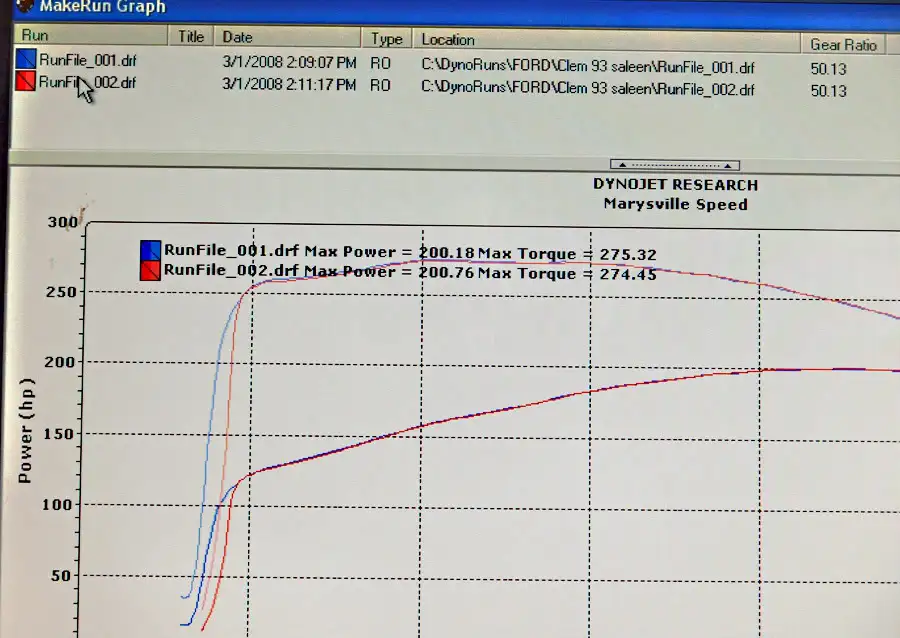

My bone stock, 19,000-mile 93 Saleen spun a Dynojet to the tune of 200 rwhp and 275 rwt.
A friend ran his on the same machine the same day and did 198/272.

At the time of that pull, it had a stock filter with the silencer removed and a clapped out pair of Flowmasters welded into the half-rotted out stock pipes. Minor adjustments have been made since. :rolleyes: My buddy Bill's car that pulled the other number is stock down to the orginal mufflers.
