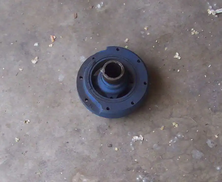

i went and got a new one from advance auto. heres a pic of the old one, the front actually had a piece of the rubber missing!! i checked the timing before and after i changed it out... it was off 3*!!
