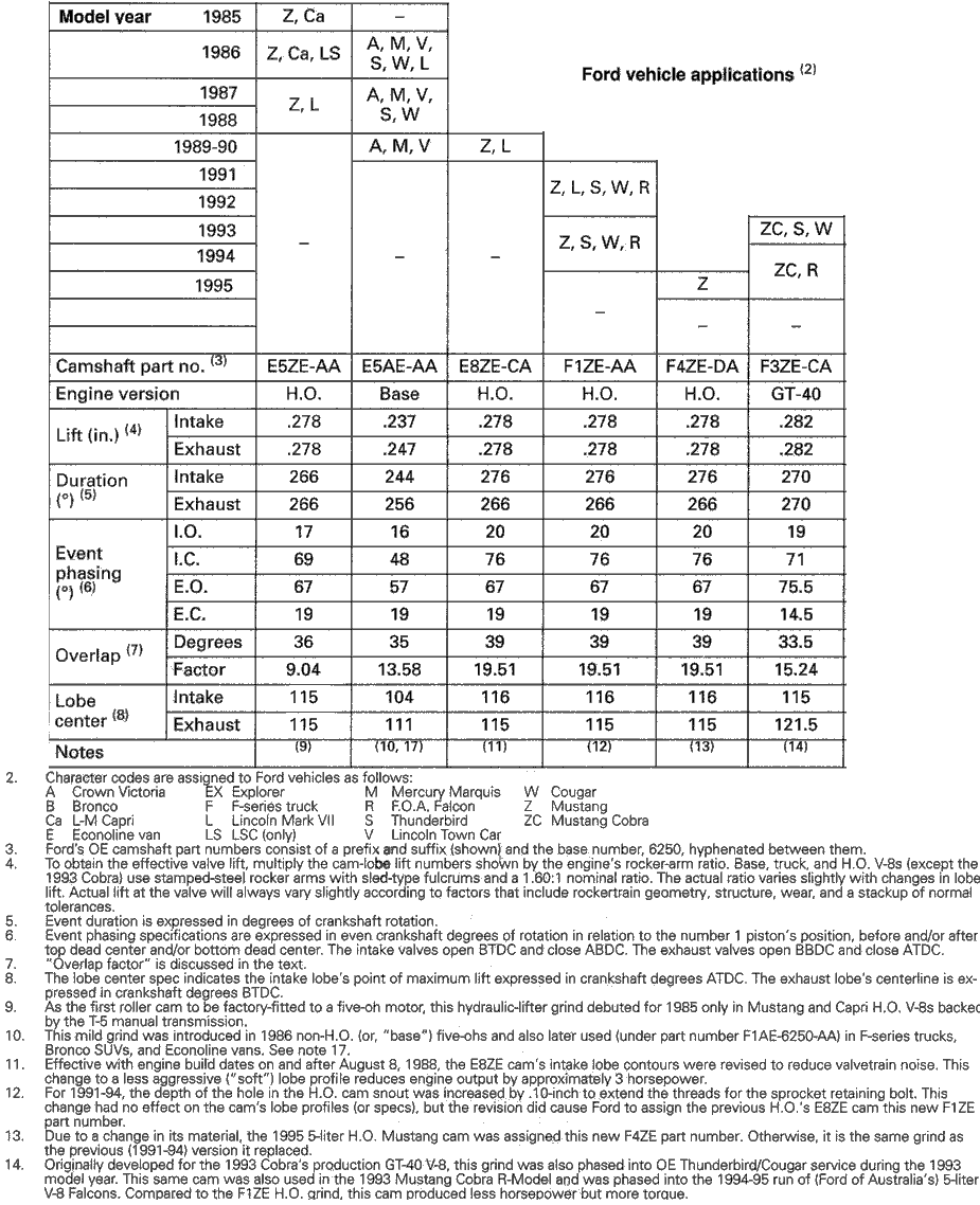

E Exrace89GT Member Mar 29, 2019 90 16 18 Lompoc, CA Aug 11, 2019 #1 Aug 11, 2019 #1 Going to degree my stock ‘92 5.0 cam. Where can I find the timing specs for it?
Mustang5L5 That is…until I whipped out my Bissell Mod Dude Feb 18, 2001 43,392 18,135 224 Massachusetts Aug 11, 2019 #2 Aug 11, 2019 #2
General karthief wonder how much it would cost to ship you a pair Mod Dude Aug 25, 2016 28,143 10,763 213 polk county florida Aug 11, 2019 #3 Aug 11, 2019 #3 ^^right there^^
E Exrace89GT Member Mar 29, 2019 90 16 18 Lompoc, CA Aug 11, 2019 #4 Aug 11, 2019 #4 Thanks, just want I was looking for.
