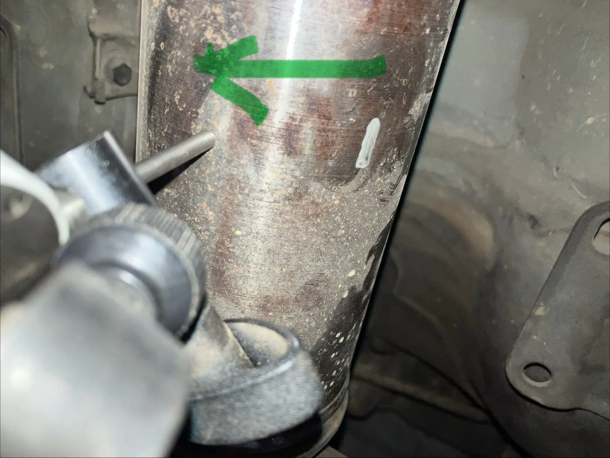

Ok I just lifted the rear and did 1/2 turn on the crank. Tha shaft did not complete a full turn. The pic below shows the indicador where the turn started an a silver mark before before completing that turn and I know I did half of the turn to the crank because my damper has laser marks at TDC (0 or 360) - 270 - 180 - and 90 and I went from TDC to 180.
So what is my 5th gear ratio? Will it be ok to asume my crank is making 0.59 turns for 1 turn of the shaft? Is that something close to 0.59:1 ratio?

You need to calculate or measure the circumference of the drive shaft. Put a pointer on it somehow (wire coat hanger comes to mine secured between the trans and the exhaust hanger plate), put a mark on the DS where the pointer is, and then put a mark on where the pointer is when you turn the motor over one revolution. Measure how far the DS turns (mark to mark in the direction of rotation).
Distance the DS moved / DS circumference = gear ratio of the gear the transmission was in when engine was rotated

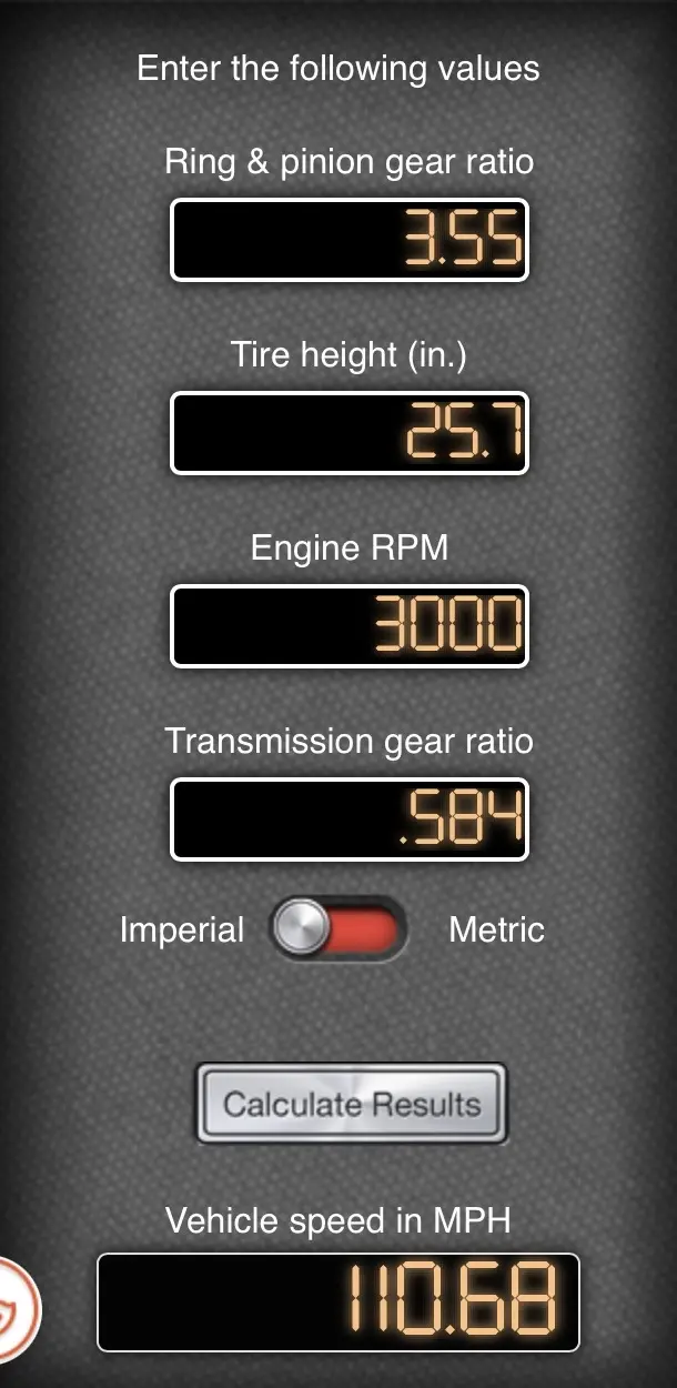

Wouldnt it be easier just to calculate it based of RPM, tire diameter and rear end ratio?
Effective Ratio=(MPH x rear Gear Ratio x 336) ÷ (Tire Diameter in. x RPM)

Ok I did your method and trying to make some sense, here are the numbers:
DS circumference: 9.5”
Pointer distance traveled with one full crankshaft revolution: 16.25
So 16.25 / 9.5 = 1.711…. And then what’s the 5th gear ratio? I’m confused

Ok then now it is making sense, with one crank revolution my 9.5” circumference driveshaft mark traveled 16.25” so 16.25/9.5=1.711 and 1/1.711=0.584 so I have what is called .59 5th gear ratio.
