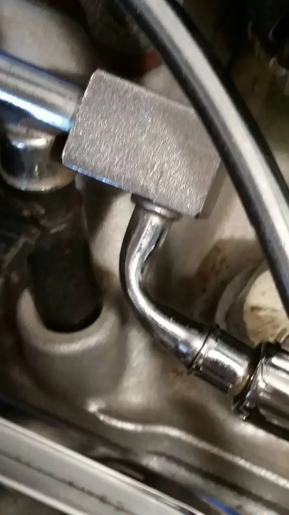

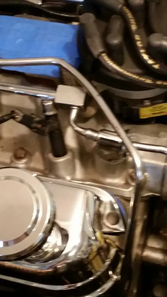

Putting everything back together and noticed what appears to be a slight kin in my factory fuel line. Does this look like it would restrict fuel flow??
On your car....probably. The stock lines are good for about 550hp on their best day.....and you've got one that's choked down to about 2/3 it's natural size. Have you got a fuel pressure gauge to see if you're experiencing a significant drop under WOT?
