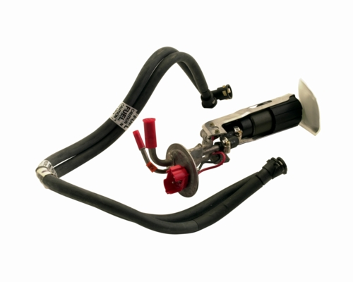

Yeah, but for the $200 you get all new lines, new bracket....everything is new - no splicing wiring and stuff.
