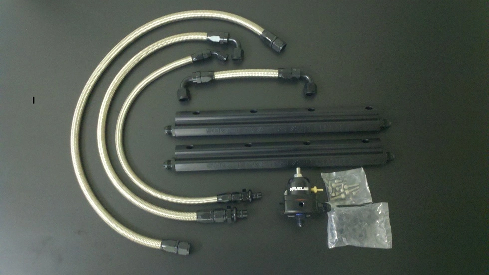

To use a remote regulator you need aftermarket rails, some lines, etc... The kit I do is about $650 assembled, I can do a complete system front to rear for $1850 shipped, BBRC alum tank, all braided lines and fittings, Fuel lab reg, BBRC rails, etc..
