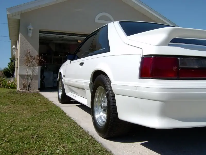

Most people go with a 15x8 with 5.5" backspacing on the rear and a 15x3.5" in the front. Here is a pic of my 88 coupe. I have the exact wheel dimensions I just listed with stock ride height. I will get some better pics in the near future. This is with a MT Sportman front tire in a 26x5x15 and in the rear a 26x11.50x15 ET Street.

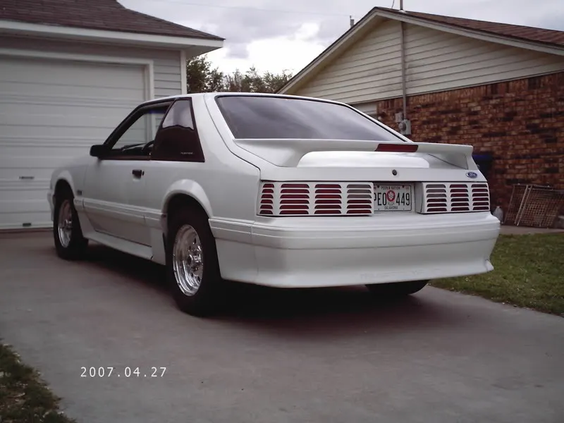

heres mine with my street tires, fronts are 165r 15 and rears are 255/60/15 on a 15x8 (5.5'" bs)

Krafty I honestly can't report any problems with the skinny tires up front. I have owned 9 mustangs and I have used all sorts of wheel and tire combinations ranging from 17x9 cobra r's to roh 16x8's, pony wheels, rodlites, prostars, and of course the draglite wheel and tire combo on the coupe. I am not a corner carver in any way so I never push the car to its limits in curves. I don't run the skinny's in the front for less rotational mass like some do at the track. I really like the look of the small fronts on most of my cars and since I don't care for curves they fit my driving style just fine.
The current coupe I have drives excellent to me. The car turns well and doesn't exhibit any push going into curves or exiting them. I have never had the fronts lock up or lose traction either. I can see how some may not trust the smaller fronts but honestly I think that if you drive hard enough to lock up the fronts that you are either pushing your car too hard on the street or need to take your car to road course events to be safe and have fun. Please don't take that the wrong way because it's not meant as negative talk towards anyone that dislikes the skinny tires up front. Everyone has their preferences and goals as to what they want their car to do. For me it's straight line 90% of the time so the skinnies work for me.
