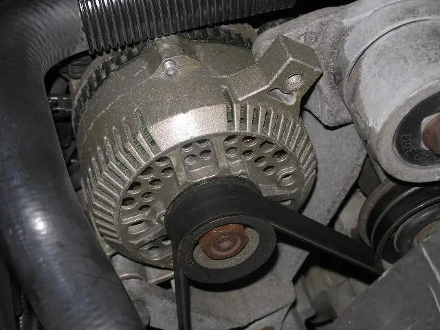

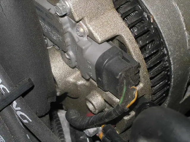

Oh I thought the 3g alternators went to a single wire connection. I didn't know the stocker had an external fan either. Heres my pics:

That looks like a 3G. Dissassemble it and have it load tested at a place like AutoZone to find out it's voltage.
While it's apart, it would be a good idea to make sure the previous owner wired it up correctly.
You could also use an inductive meter to see what kind of juice it's putting out. I've found that advertised output means little on a used/otherwise unknown alternator.
I've seen some upgraded 2G's that are higher output and I never understood how they got more juice out of them while still using the crap OEM charge cable connections. In other words, I wouldn't want more than 65 amps running through those connectors.
Good luck.
