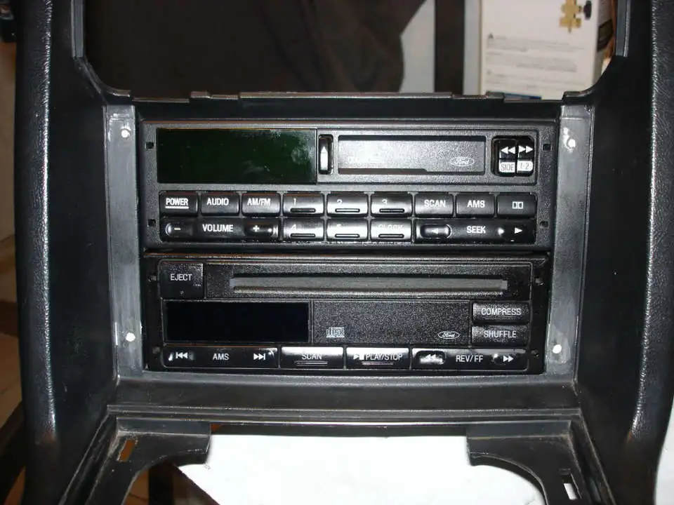

From a 94-98 mustang? Isn't the cd player and stereo separate in them?
Yes, but it can be made to work. The 94-98 Mach setup works with the 93 premium amp setup.
I was going to do this in my car, but went with the OEM 1993 CD player instead as I don't even own a cassette
