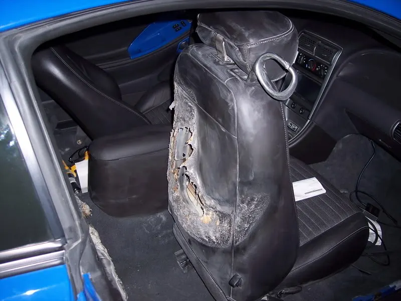

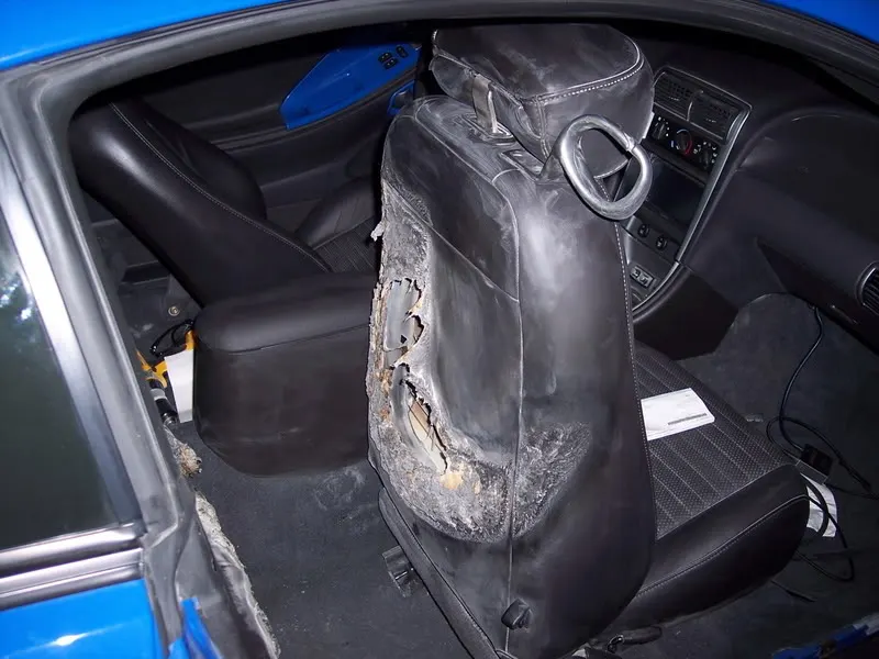

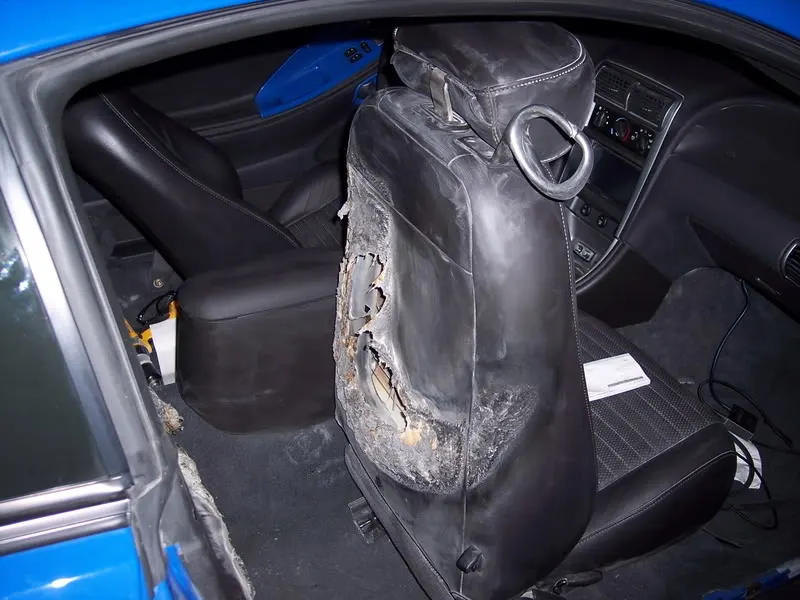

Make sure you pull the carpet as well. Don't want this to happen.
You beat me to it.
Pull the interior yourself and get the car preped for it ahead of time and it shouldn't take more then 1 hour of labor.

Yeah a welder sleeping on the job would do that, you don't need to pull anything out, just try to move the fuel lines out of the way or cover them up.
:stupid:
these are standard length sfc's, not much welding involved so i think i'll be ok
The shop that made and welded mine in on the Cobra didn't pull the interior. All they do is cages, and subframes and metal fabbing, so they just must watch the interior with one dude while the other welds. They said they did not pull my carpet. IF so, the price would have doubled.
