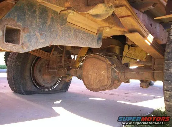

as far as I knew the f250 had a diff. rear than the 8.8 (maybe thats the HD 3/4) not sure though now that its brought up? The 1ton should be a 10.25 sterling(sp?) rear or dana 60+ and is HUGE.
the 94-95 is a 28 spline t-loc, the 8.8 F150's had a 31 spline t-loc stock The years should be something like an 87-96.

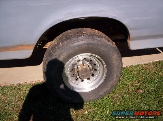

Seems that 87+ with need of VSS were 10.25 sterlings, and non VSS were Dana 60-70's. So no 8.8 in the f250's.
That is a part number for a 31 spline 8.8 but does not say f250 http://www.lmperformance.com/6488/50.html
