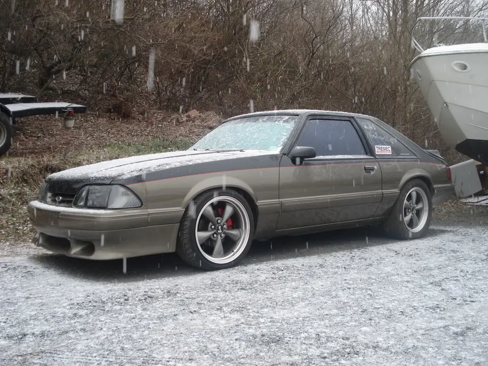

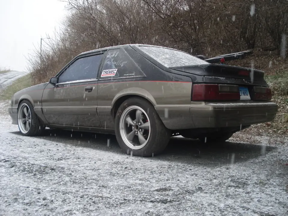

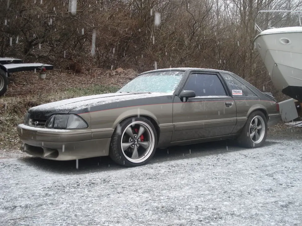

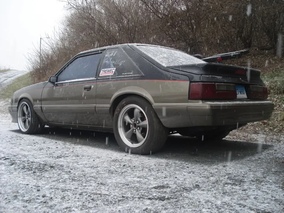

You got me beat... Mine is sitting in the gravel driveway, uncovered, in front of a 25' boat on the ET Streets and Bullitts. It gets rained on, snowed on, frosted over every morning...
It's a sad sad sight right now!

Yup thats where it sits, dirty, messy, might have a flat tire on it. Its going to be stored under a cover in the enclosed trailer, but my father wants to lay a floor fown in there first... Needless to say we haven't done that, and the car sits outside.
I think I win for cars hating us... :D

Eh, snow doesn't hurt a car any more than rain. Its the toxic salty slush that builds on the bottom of your car if you drive it through the winter. It eats it from the inside like meth does to an addict.
25th, I can stand the car sitting in the gravel under the weather if you get rid of the sticker, haha.
yeah you win! hey 25th what is the name of your bottom grey color. i decieded to keep my car silver but i want to go a little darker than just broing ol metallic so i was thinking like a shadow silver/grey:nice:
