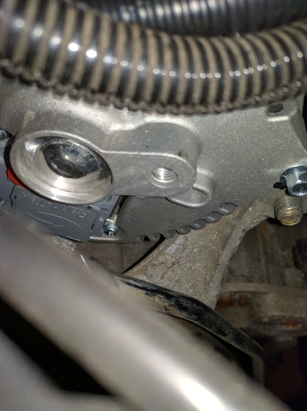

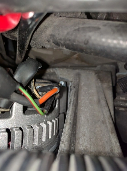

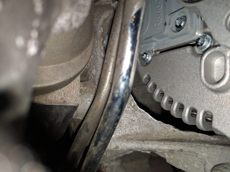

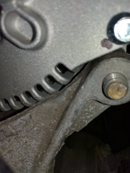

I upgraded to a 3G alternator in my 93 GT. Every since the upgrade I have a strange noise coming from the engine bay. Car runs perfect, good oil pressure, etc. I noticed the back of the alternator was resting on the bracket. Is it supposed to be touching? If not, could it be vibrating against it. The noise sounds like you are shaking a cup full of rocks. It didn't happen until the upgrade.
I notched the front, not the back.
It is clearing now.
