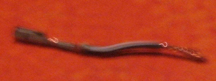

I am in the process of removing an aftermarket alarm/autostart.
Behind the driver side kick panel there are a bunch of wires.
There is a factory Brown with white stripe wire that was split,
with 1 part connected to one aftermarket wire and the other part
connected to another aftermarket wire. In the process of removing
the aftermarket wires and reconnecting the one half of the brown with
white stripe wire to the other half of the brown with white stripe wire,
I pulled the one half out of its harness. So now I have the brown with
white stripe wire with a metal crimped fitting/pin on the end that came out
of the terminal and no idea which terminal hole it goes into.
There is a long black terminal (closest to the front of the car), then a
small white one next, then a small black one (farthest away from the front
of the car) that this wire fell out of. So I know which terminal it fell
out of but not which blank hole that it goes into.

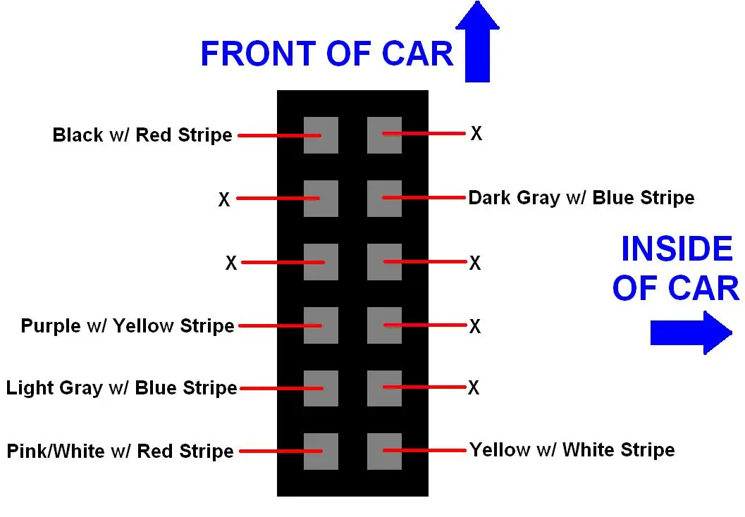

from the above reply, it seems to be the "Trunk/Hatch Pin brown/white - 12 pin plug, pin 3 at GEM"
Can you tell me which one is pin 3/ what the orientation of the pin order is for the clip.
I also attached some pics i took last night.

In your pic of the connector it goes in pin 3 on the left side from the top above the purple/yellow stripe wire.

thanks guys, ill plug it in there and make sure the button works to pop the trunk.

seems to be good, thanks
