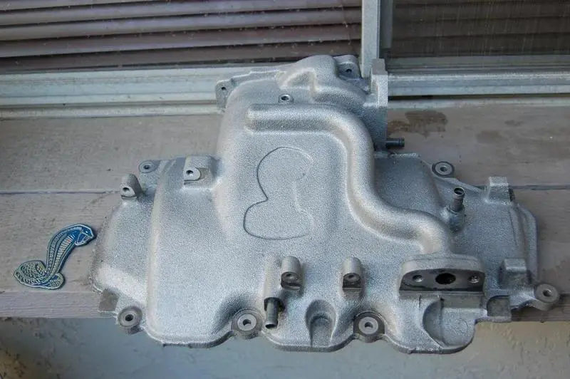

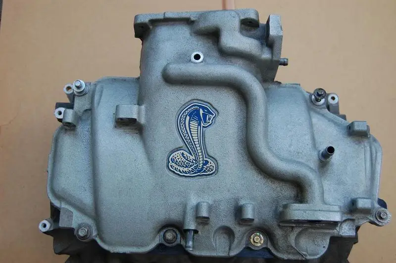

Aircraft paint stripper - i've used it many a-time including this week:
http://www.farmandfleet.com/catalog/product.aspx?i=455125&h=080305005
Found at any hardware store, wont be locked up with the spray paint.
Please use gloves. Chemical burns are no fun, it'll try to take the paint off your skin, lol.
