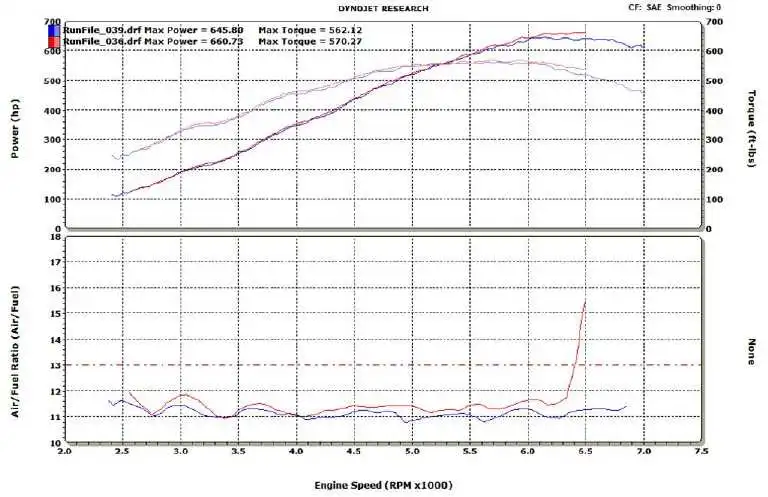

jimfitzgerald said:
My supercharged MPH stroker is making 825 hp at the crank.
Uhmm.........wait....let me digest that.......uhm..... :shock:
What kind of supercharger you got on that thing?...you've both made my day and ruined it with your super awesome engine.
What does your power curve look like if you don't mind.
Like this: click on thumbnail
boomshack said:
This looks like a perfect setup for drag racing....how does it perform on the street as a daily driver for you? Thanks again for posting the pic.
It does fine on the street except with the 4200 stall torque converter, I only get 7 mpg around town. On the highway, it gets 14 mpg.
