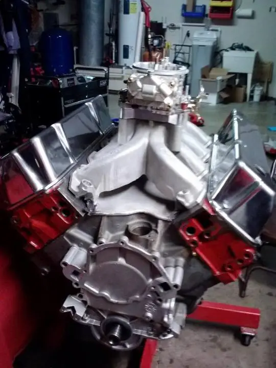

and here is a photo of the clevor from Friday night.....
