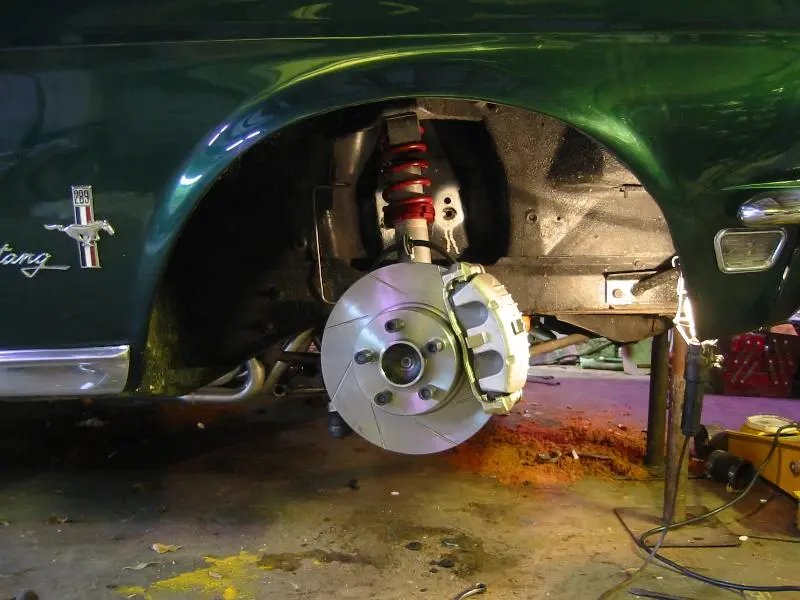

I have a set in my car. I put them in after having done a front end rebuild (shelby drop, 1in springs, sports shocks etc) and the imrpovement was substantial. It would have been best not to bother with souping up the stock stuff and going straight to the RRS if money permits. Keep in mind you get a good brake setup in addittion to the struts.
See my link below on corner carvers for more info (my post is at the bottom).
If you have any questions fire away.
http://corner-carvers.com/forums/showthread.php?t=15417

Keep in mind there is a difference between handling and ride quality.
Edbert - I've heard the same thing about struts & bmws, but I dont believe thats a good enough reason to discount them. If they can be made to handle well, and made to ride well than it doesnt matter. Both modern porches and bmws use strut suspensions.
I'm not saying the RRS struts will make your mustang handle like either (lots more deficiencies need to be fixed, eg chassis, rear suspension), but they are a big improvement in ride quality, and a definite improvement in handling over shelby dropped lowered etc mustang suspension.
I cant compare what its like with a TCP/Global west/etc setup as I haven't had the opportunity to try one.
The adjustable ride height is nice too.
Here is a pic of the installed strut
See pics of the install here here
