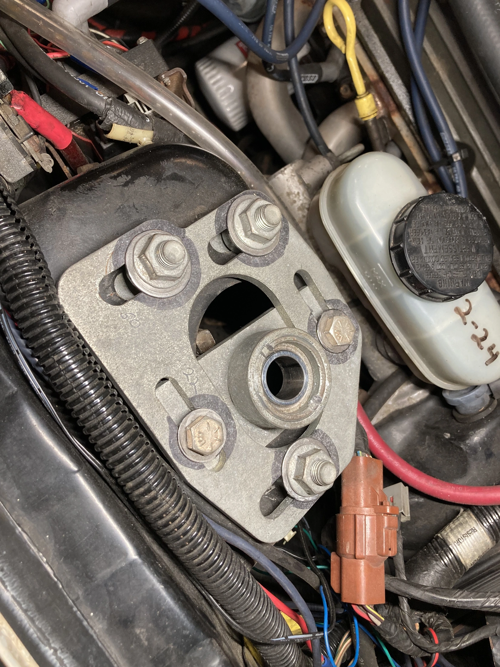

Ive got Lakewood adjustable front struts and UPR camber plates. All the bolts are tight but I still hear the rattle. Most noticeable crusing through hood no load roughly 25mph. Is there a trick to quieting these down? What other components should I be looking at? Sway bar mounts and end links look good. Tie rods and ball joints have no play.

Did another test drive after making double sure all camber plate and strut mount bolts are super tight. Still rattling. I also tried coasting and applying slight braking to see if engaged calipers changes the noise. No change

Spring isolators on top and bottom. Plastic splash guards are a little loose but I seriously doubt they would make the kind of noise I’m hearing.
Is the spring free and clear of everything (imagine some slight articulation)? Can you rock it back and forth by hand, so that it's not?

I unbolted the top of the struts and removed the spherical bearing retaining ring. The spherical bearings are tight and have no slop whatsoever. So I can’t see how replacing them would solve it.
