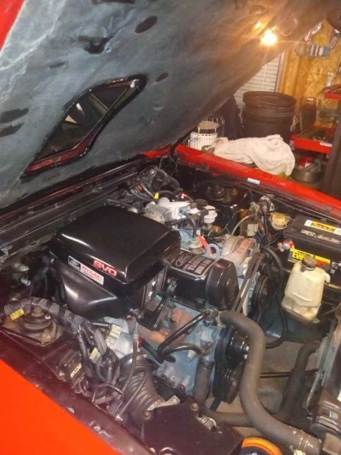

Has anyone found a upper strut tower brace that works for the 2.3 turbo? Most of the products state that they wont work for 2.3 applications due to alternator issues, so thought it best to ask before starting to make something fit
Thanks
Reactions: Piranahbite
I know some have had issues with the Maximum Motorsports unit just barely touching the top of the alternator and translating a lot of noise. It’s possible you could install a small case 3G alternator and get the necessary clearance. Not a huge gain in amps (75 vs 90) but if it is 1/2” smaller in diameter I think the brace would fit.
Reactions: chilsam
Update - the AC brackets will definitely work with some modifications, but the AC compressor sticks out further than the Alternator would so have to build spacers to move it out in line with the rest of the serpentine belt. Will get it all mocked up and see if it is just easier to build a new bracket as trying to find the correct Pinto or Ranger assembly is like a dog chasing their own tail.
