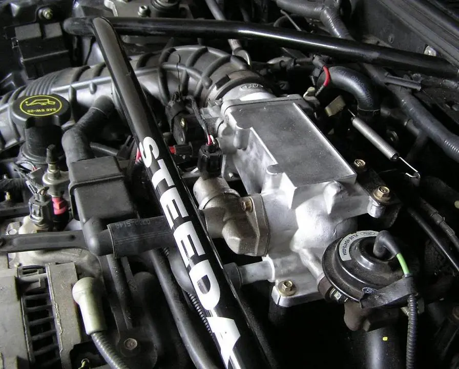

I found it quite an easy install.:shrug: Once you mark the holes where the brace was going, drill and bolt it down with the supplied hardware. I could have chosen to tap the holes, but felt it was easy enough with the bolts. I had the front jacked up under the k-member allowing the wheels to drop and could reach behind fairly easy. I also took my time on the rear firewall and cut the plastic so it fit nice around the STB for a cleaner look.
BTW, I installed a Steeda chrome moly version for it's lightweight but still strong, powder coated black and clearance for CAIs.
Here's a pic.
Here is mine from STEEDA. Although I put that "steeda" lettering on the center of the brace. I have access to a vinyl sign shop :)
It was a little pain in the A$$ to get the strut tower brace installed around those C/C plats
