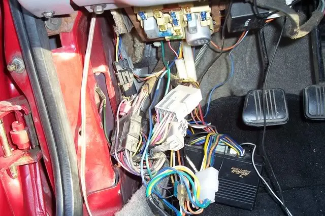

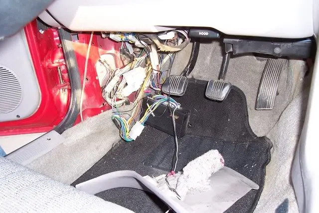

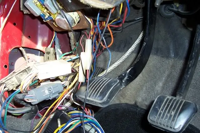

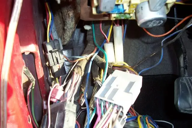

here is what my wires look like theyre just laying out. the guy that fixed the car was a retard, he just left it like this :nono: :notnice: , now the stereo doesnt work and the doors unlock when i start it.
This probably wont help, i just wanna show yall my screwed up car.
