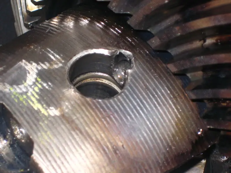

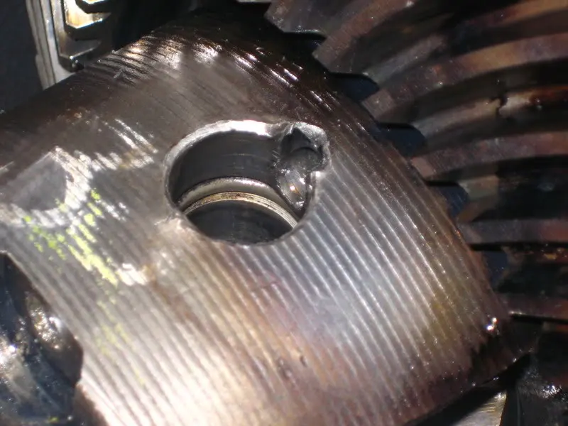

Well, I got it out...
Oh well, just a worthless 7.5 non-posi.
