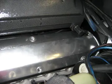

Where do that plug on the intake go plugged to...Its a vac of some sort, I know that. but cant remember where? Is that the PCV...
No, the pcv is on the back of the lower intake. What you are lookin at is the port for the vacuum coming from the tree.
If it's hitting the v/c, just take that fitting off and cap it off, that's what I did because I had the same problem.
FWIW, you really don't need to use all the ports on the intake. I just have one to the vacuum tree and one from the intake to the FPR, and that's it. I'm running not pcv.
