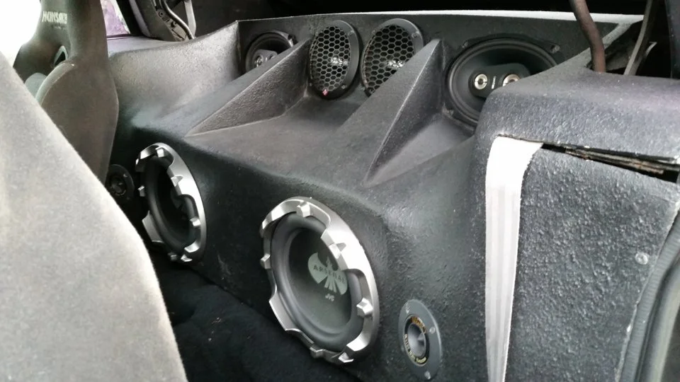

A few pics of square stock laid into place then measured across from worked well for me. Or just "piece" it together from square stock and measure your box dimensions.
I just used square stock and stapled as I went along until it fit snuggly into place, then stretched fleece over the stock. Fiberglass followed the fleece.

You asked I gave a tip, it's what we do here. I don't know if you were paying any attention, my box form fits my entire back seat. It even has the provisions for the seat belts and the clips for the top cover. It has to be removed in one piece with the top down, takes 2 people. All my amps are mounted behind the "box".
