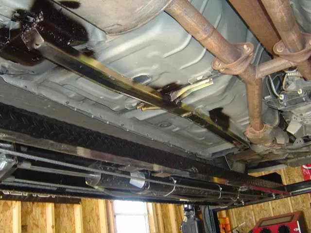

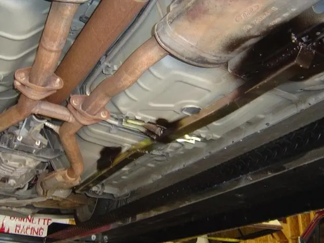

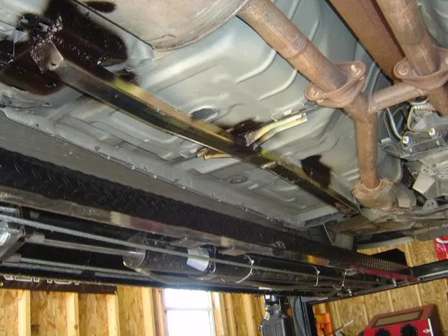

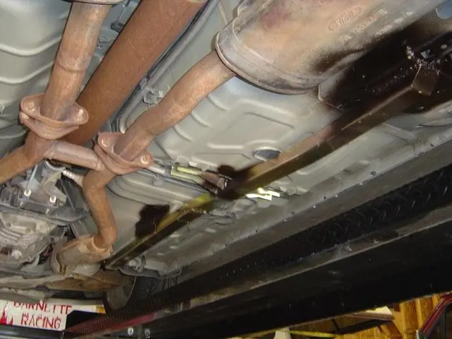

I have had zero issues with my steeda's. They are full length and came with the rear torque box welding plates. I tried to put underbody coating on the welds to preserve them from rust... didnt work too well, what do you guys use?

What would be the advantage of getting powder coated sub frame connectors over bare steel? I think Im going to get these for my next upgrade. How hard are they to install or how much would the average shop charge to install them?
Powder coated = rust protection pretty much. Uncoated they are open to the elements. Up north with the road salt winters and whatnot rust is an issue, but around where I live (the south) we enjoy rust free cars and trucks...:D
And OT... but looking at those pics above makes you realize how crappy and restrictive the stock exhaust is. Dang... 4 cats, and the H pipe doesnt look like it would even do its job. X PIPE FTW!!!
