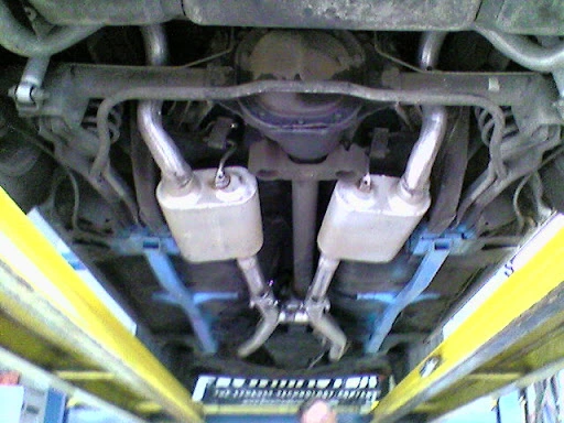

I didn't have to remove anything to put mine in. Although not anywhere near show quality here's what they looked like installed on my 90 vert.
Sorry for the fuzzy cell phone pic. And the overspray is just from painting the welds.
