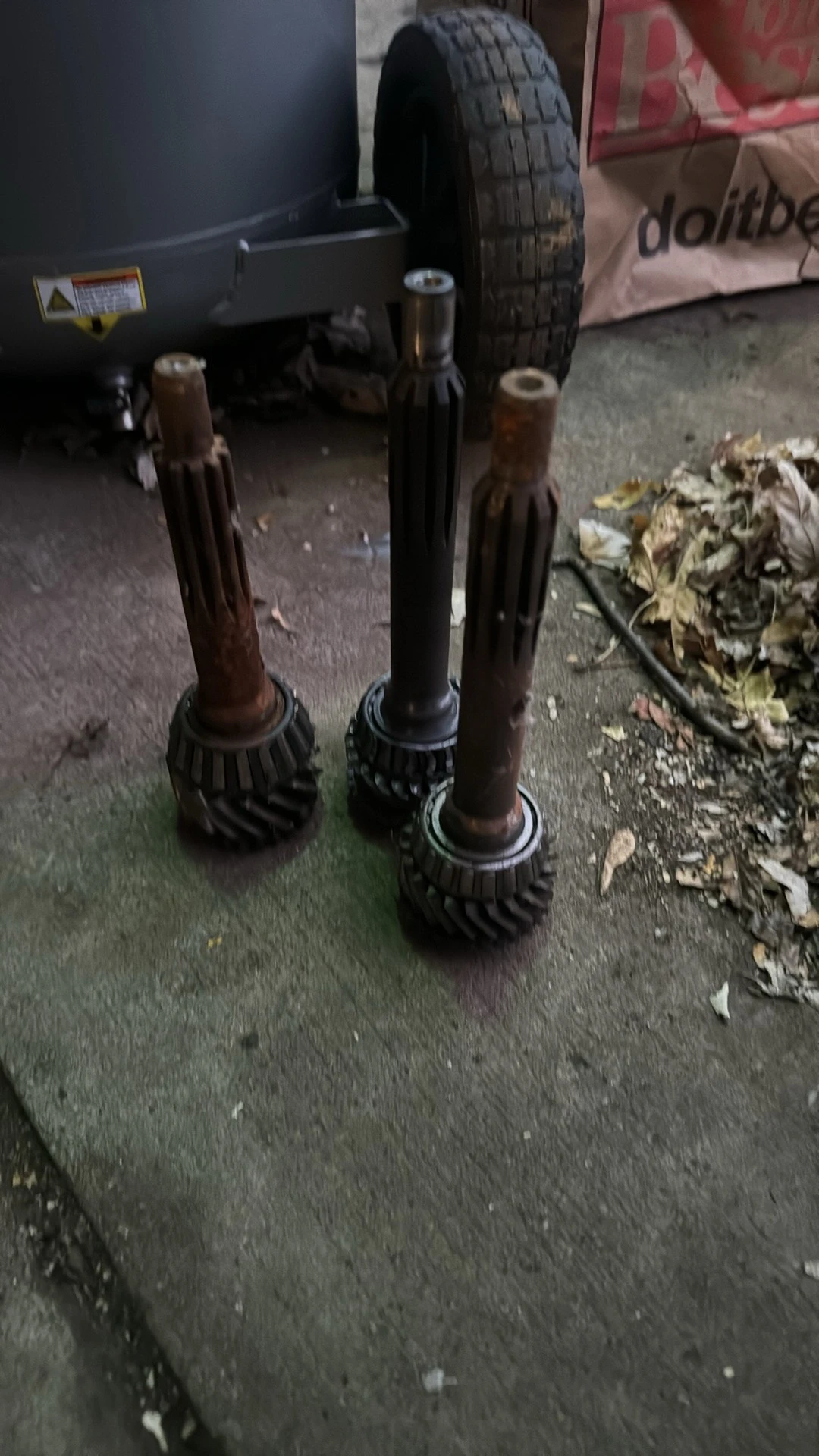

So i was out cleaning the parts warehouse, formerly known as my garage.. and i found an input shaft!! anyone know what the gear that the input shaft gear rides on is called? it pretty chewed up as well but everything else looks fine.

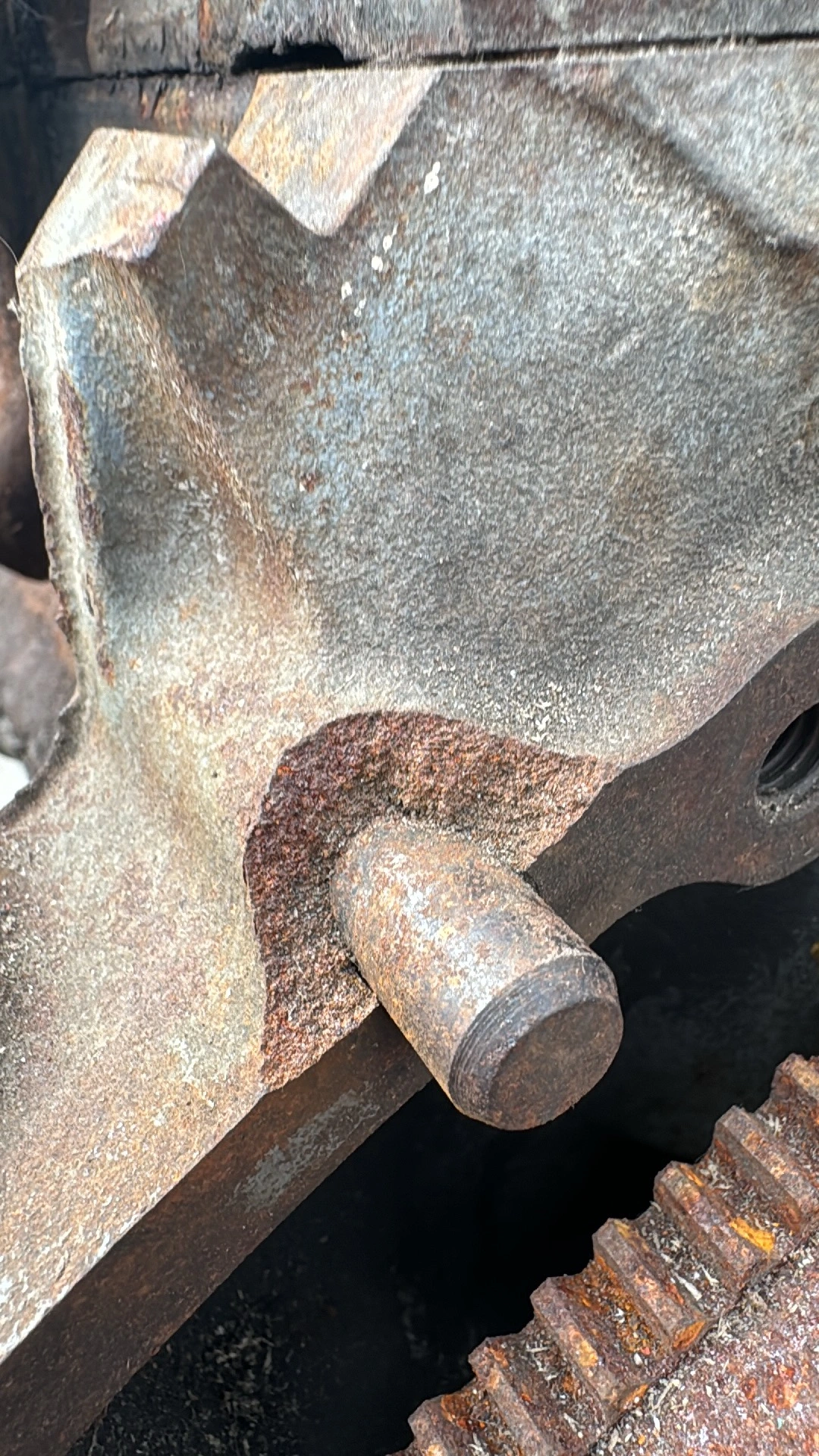

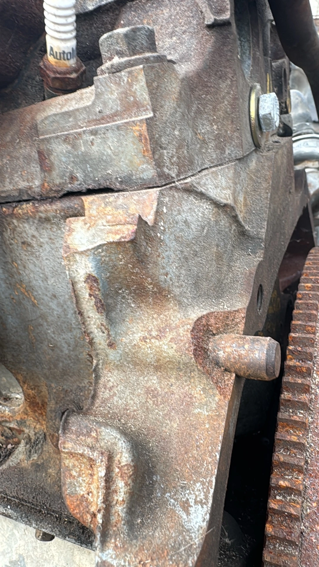

Alright so i got the ole 94 351 out of the garage today and i noticed where the dowel pin goes in the block where the bell bolts is cracked and it looks like its real flakey. is this something to be concerned about or do i just run it? Also i had a sever screw up when i was a kid and tried to drill out a btoken bolt near a water jacket, which i had filled with tig and i now need to drill and tap. anyone know what size drill and tap ill need? or at this point to i just go get a new block?

I’d just put the bellhousing on, bolt it down and call it a day. Those dowels are more for alignment but the bolts are providing the clamping force.
