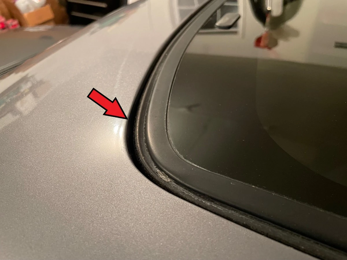

A factory sunroof has a rolled edge from the roof to the drip well just inside the the sunroof opening...

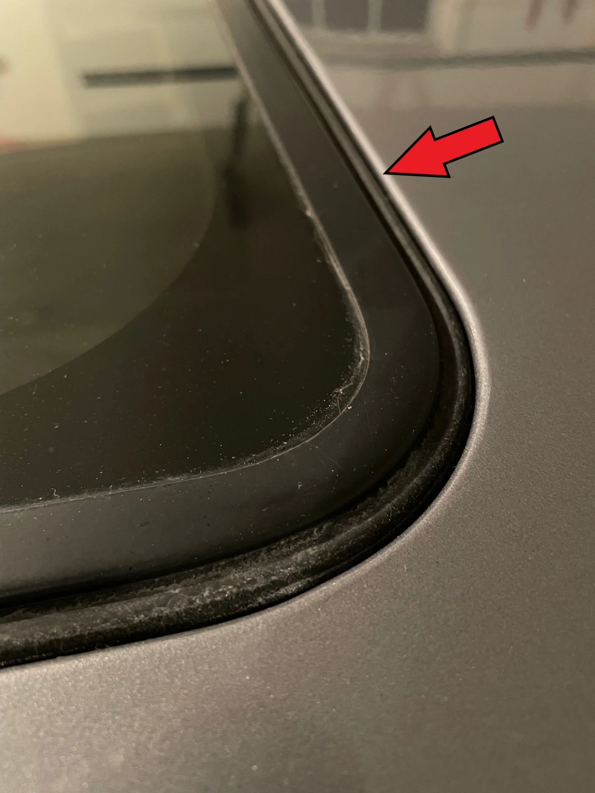

An aftermarket sunroof will have a flat rubber weatherstrip the overlaps the sunroof opening (since they have to cut the roof for the sunroof opening).

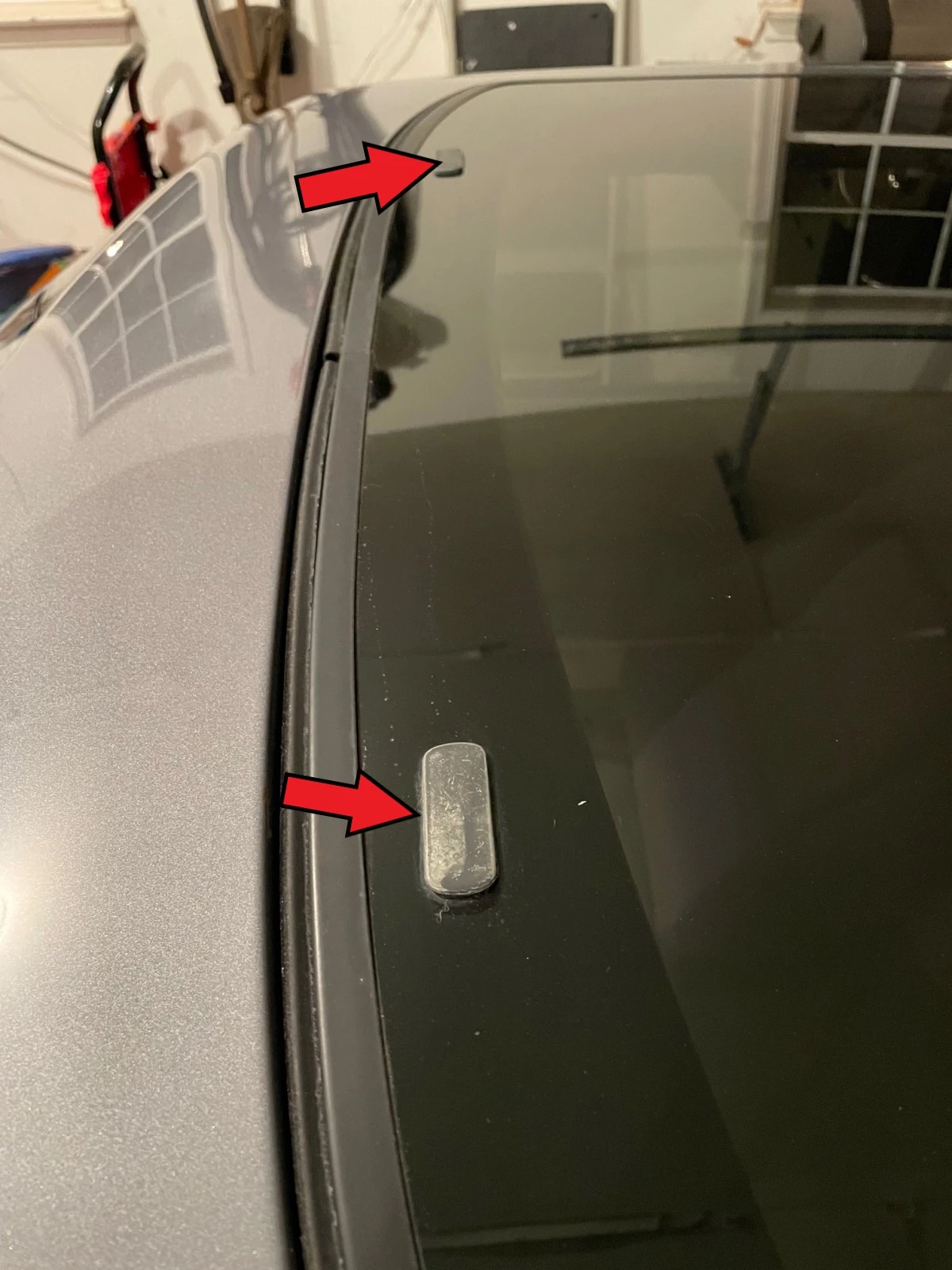

The factory sunroofs have two metal "L" shaped brackets at the front that slide into plastic yellow brackets at the front of the sunroof opening. The yellow brackets are set into the drip well. This pic shows where the "L" shaped brackets mount into the sunroof panel from below.
