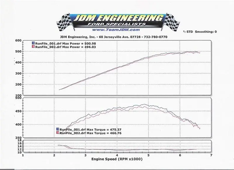

I'm at 500rwhp with a Saleen on a JDM Stage II kit and stock internals.
Granted you'll need longtubes, upgraded fuel system,and a few other mods but it can be done. I have put over 12,000 miles on the car since the install with no issues other than broken tensioners due to powershifting a manual trans. All of the above blowers have the same issues if you do a search.

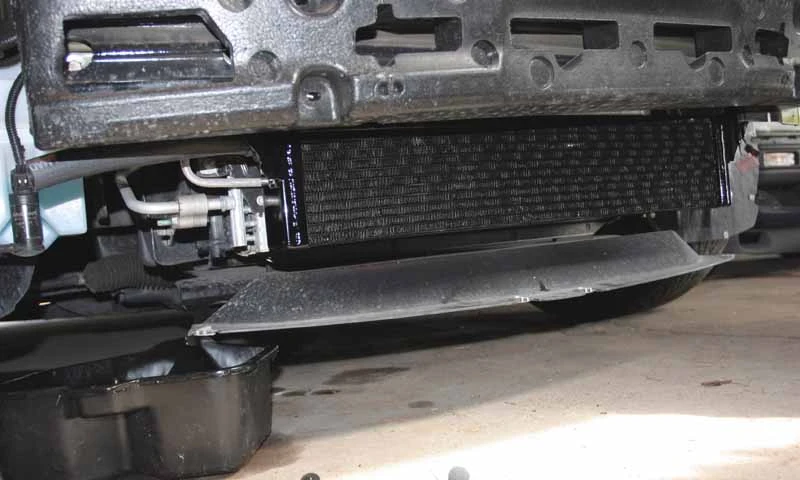

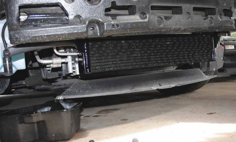

I know the whipple and KB run an external cooler, does the Saleen? I have seen no reference to this and I have been looking around. I know brenspeed sells and installs various stages of saleen sc and they install for only $650!!! And the stage 4 kit is only around 6 grand. So I can get an electric h20 pump, the complete saleen kit and have it installed for 7K.
I'm not sure what you mean by an "external cooler"? Are you referring to their use of a "heat exchanger"? All of the modern Positive Displacement kits that I know of that utilize any form of intercooling utilize some version of an air/water set up. Usually some sort of Spearco style "brick" as the core, mounted just after the discharge port of the blower that's there to pull the heat out of the air charge. The temperatures of the brick are controlled via an externally mounted heat exchanger situated up front for catching incoming air through the grill opening, to normalize coolant temperatures after the event.
The only positive displacement kit I can think of that doesn't do it this way is the OEM set up on the earlier Thunderbird SC's and Supercharged XR7's.
Yes....assuming it's the intercooled version of the Saleen kit, it will also utilize a front mounted heat exchanger in it's design just as the Intercooled versions of the FRPP and Kenne Bell do.....as does the Roush and Magnacharger kits.
Saleen Heat Exchanger....as seen here!
