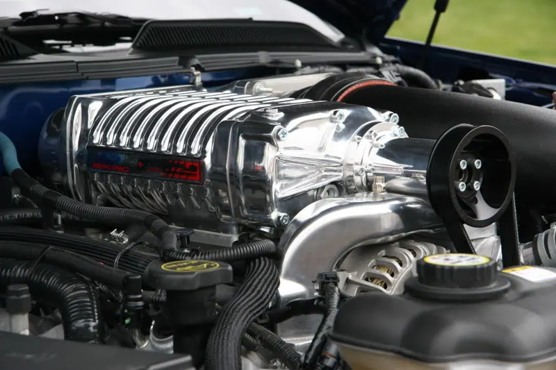

Just installed the Kenne Bell 2.6L (intercooled) today. Well, actually I took my time and spread it over three days. But I could not get the grin off my face, nor the grins on my sons faces when we finally mashed the throttle.
At 10 psi I'm not too concerned about the stock block giving out. And if it did, that'd be just the kind of ammunition I'd need to convince my wife I need a new motor. Then I'd turn up the wick on the SC.

Let's see the new hardware - share the grins!! :nice:
