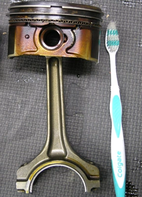

Haven't heard about that. Any year 05 and up, when your at 500rwhp your on thin ice when the bottom end is stock. Some that are well tuned, or not racing that often are surviving, but I think failure at that point is not a matter of if, its when. I built my bottom end with JE pistons, scat rods, cobra crank when I knew I was going over the 500 mark. I also race mine quite a bit to. You will like this pic:

well i think i'll probably avoid the high end horsies for now, 415 rwhp sounds just about right, i'll probably upgrade the suspension next, then brakes, and maybe tranny. Whats that pic of btw? A super whippled out piston i take it? And also do you got an auto? (thought i noticed it on your signature)
