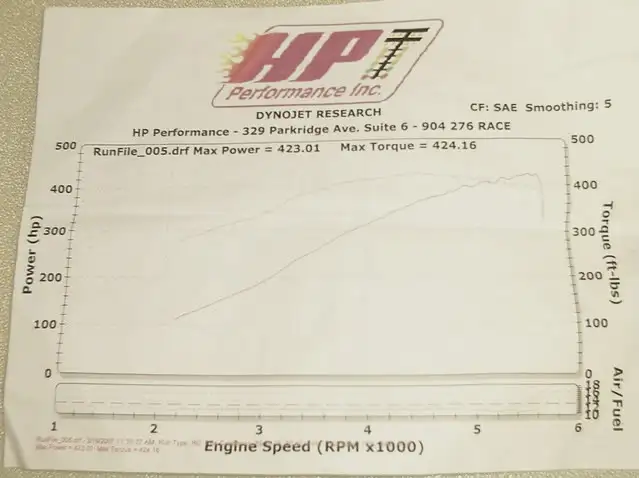

The name of my shop, and someone I really trust with SN95's is HP-Performance in Orange Park FL. Not sure if he'll ship to Canada, but if he burns your chip, I'll go up and ship it for you if need be.
Here's the dyno sheet with their number right on it for ya:

right on man your awsome. I only have one problem, I am at work right now and the network is filtering the picture. If you have time to post the number that would be great.
