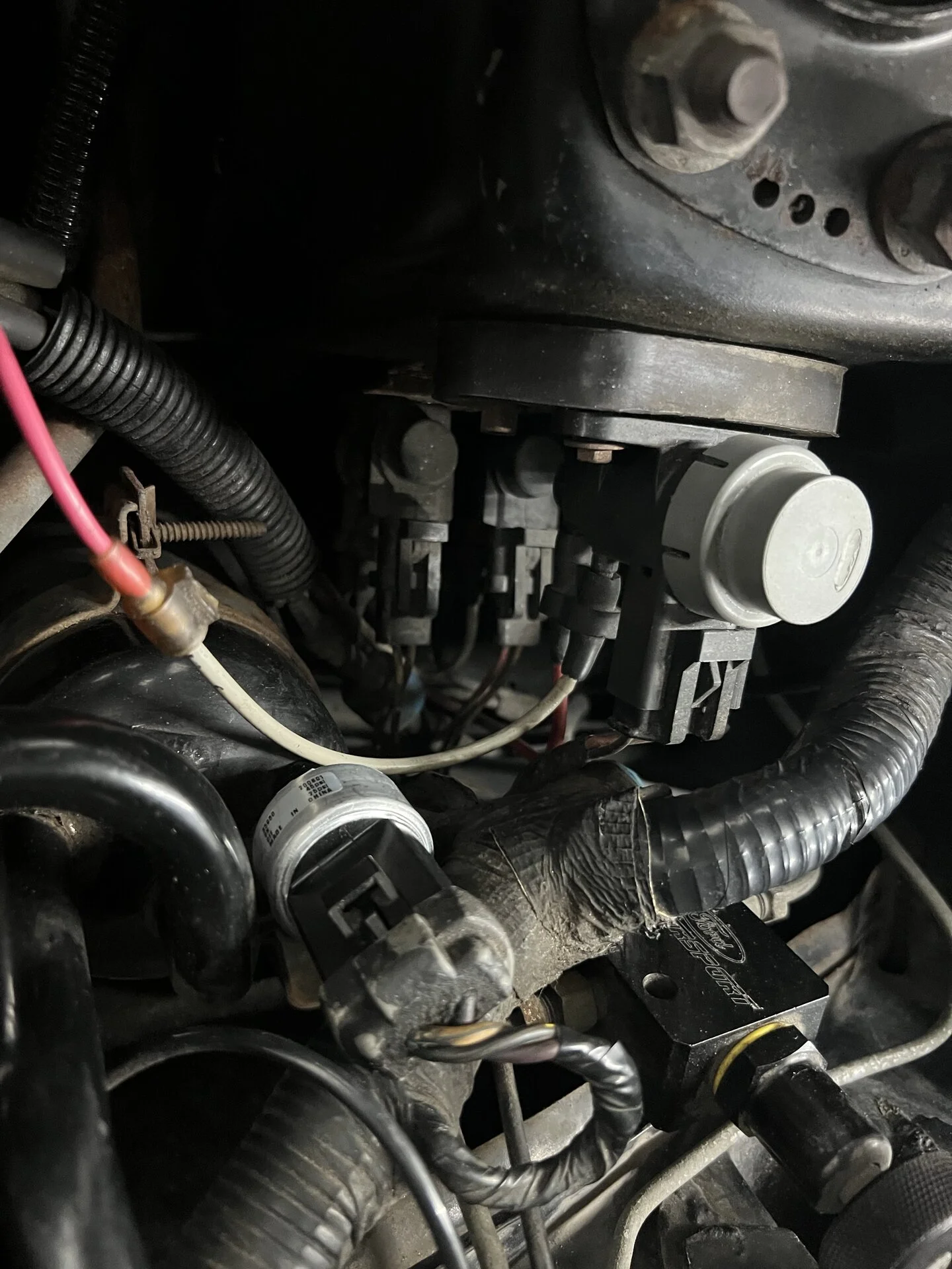

I believe those codes are related to the tab/tad solenoids behind the passenger shock tower, are they there and vac lines hooked up?
Yes they are all there and hooked up. Is it true that the key in engine off scanner test checks the solenoids because I hear clicking sounds and I don’t get any codes besides 11
