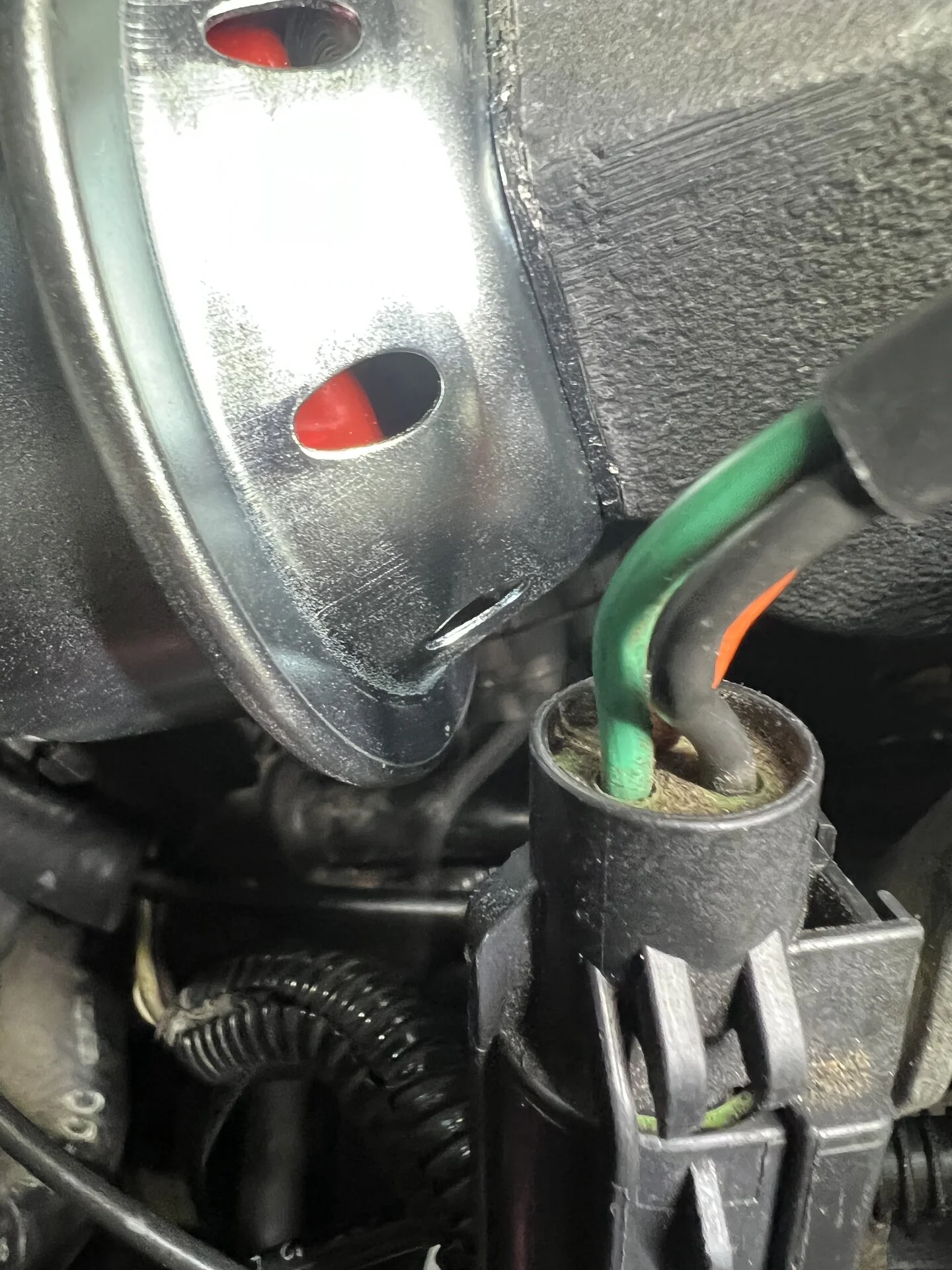

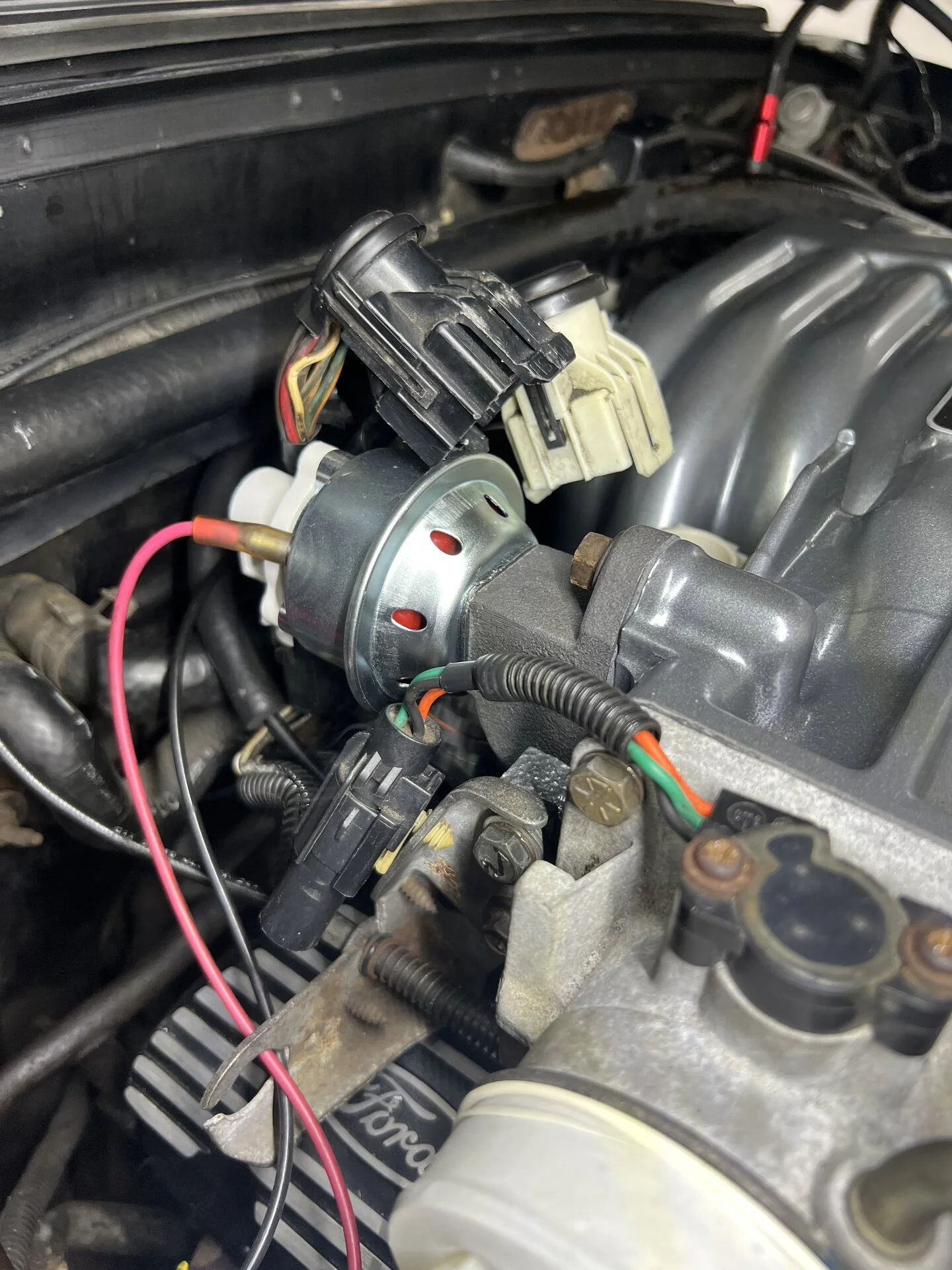

So I just installed the new iac, egr, and I cleaned my salt and pepper shakers. Did another smoke test right now and the new egr is leaking just like the old one. Is it supposed to do this or did I get a bad one? Don’t know how well you can see it in the pics but it was a pretty good leak coming out of the holes.

So I just did another smoke test and found a lot of smoke coming out right above the starter. Upon closer inspection it looks like it’s coming out of the oil pan gasket. I also had a lot of oil coming out around there too. Can that be causing idle issues?
Oh if you were talking about the egr smoke possibly being the intake gasket no it was definitely coming out of the egr metal holes. I did another smoke test without the egr and I taped the holes and that was when it all started coming out of the oil pan gasket
Now this is just my thinking, if the intake gasket is leaking at the bottom where it seals at the lifter valley then the crank case thus finding the oil pan leak, another possibility may be the pcv is letting the smoke through to the lifter valley :shrug:
I’m a little confused so are you saying that the smoke shouldn’t be able to reach the oil pan unless something is leaking somewhere and letting it in?
That's my thought process, yes.
Now I could be wrong, I'm not Melvin (were did that come from!) you took the hose from the throttle body to the oil fill tube off and plugged the throttle body? The only other way, I could be wrong, is a bad intake gasket, pcv or really bad rings (in that case you would have been smoke testing your neighbors).

Haha. Oops no I didn’t know you were supposed to take off that tube that goes to the oil fill tube. I did put a glove over the TB. Do you think that’s why?
