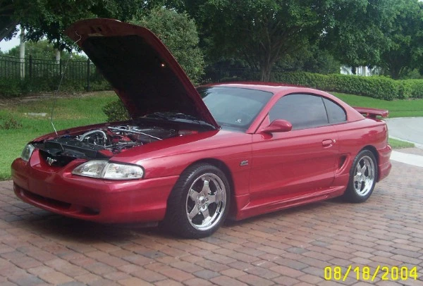

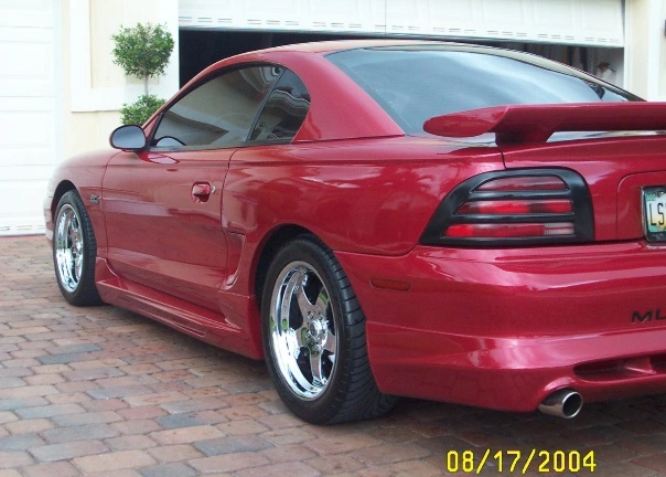

Hey RC how about a pic of your car with the new rebels on it.

I would put the link from last week, but I dont want to revive that thread...so here's 2 of them. ( :OT: , but it IS MY thread )
