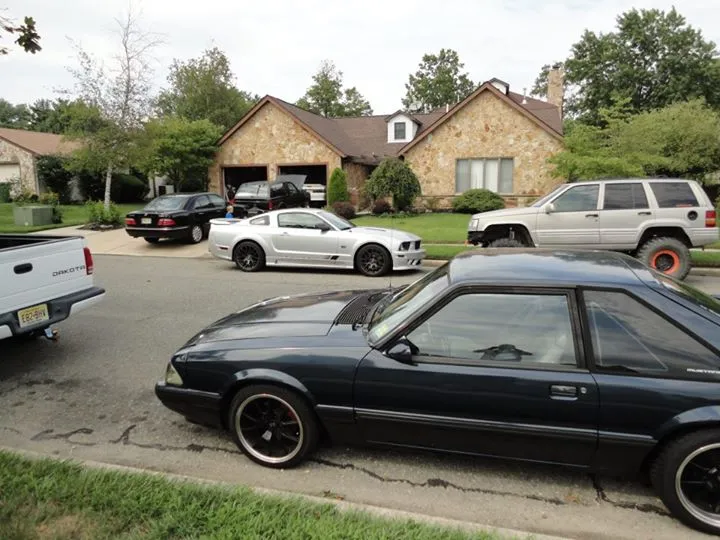

SN95 brakes. You'll want 94-95 spindles up front, and you'll want to keep fox track out back using brackets from north race cars.
You can pick if you want GT or Cobra brakes.
That will fit the wheels like as seen in pix, and then you can drop it accordingly

My daily driver's had 94 spindles, 99 pbr dual piston calipers with ranger axles and drums out back for years now with zero issues.
