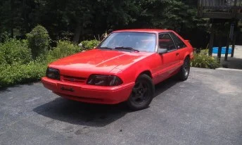

Hello everyone,
So I have been thinking and planning my spring projects for my '88 LX, which is a bit preemptive, but what else can a poor college student do during the winter.
So I will hopefully be putting in a set of Eibach pro-line springs within the next month.
After that my plan is to focus on suspension and brakes. First off my shocks and struts really need to be replaced....blown bushings plus the shocks seem to be the factory original. The bushings I will be doing this month as well, but those are easy and cheap for the stock replacements.
Keep in mind:
-Street car that is my everyday driver. Everything is stock except exhaust.
-This is my first mustang that is also my project car. It runs and drives, but needs a good amount of TLC. So it will be a slow process while in college.
