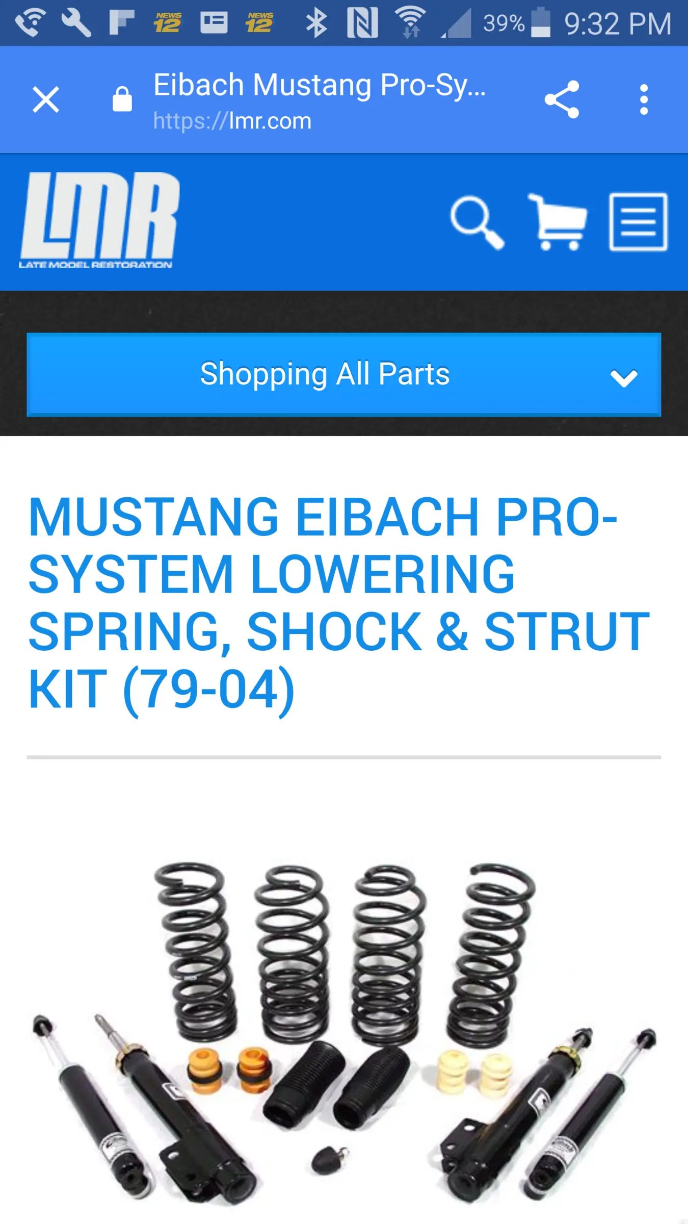

So now that LX is loud and lumpy it's time to correct the 4x4 stance, don't want it down in the weeds and not interested in racing the car, so I was thinking Eibach pro's and new shocks and struts and came across this package. What do you guys think? Just started my research and have even looked at some coilovers stuff but maybe that's beyond what I need. As always your input and opinions are greatly appreciated.

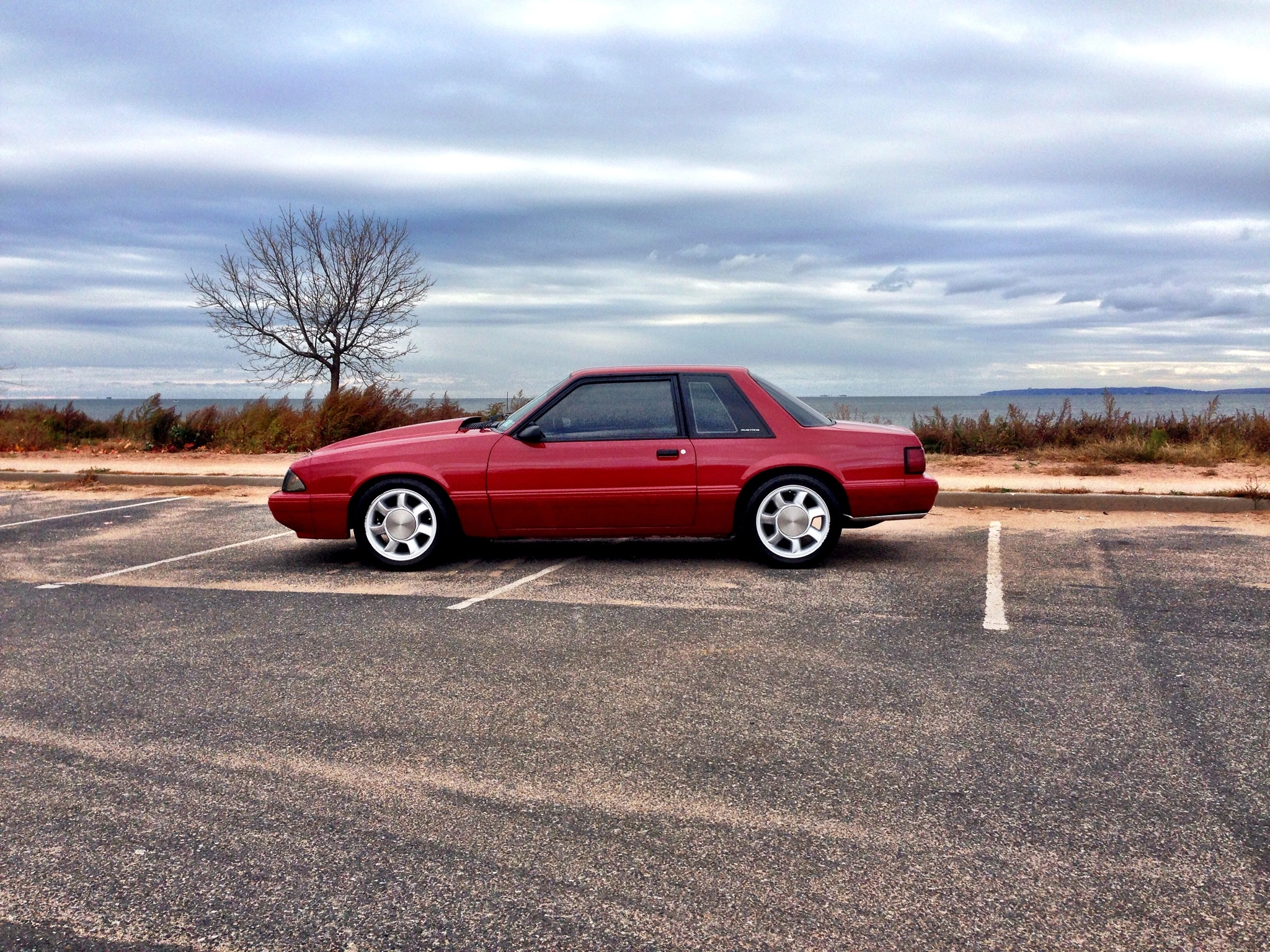

This was when it had the pro kit and the tockico blues . 1 ISO removed upfront and no rear isolators . That was also with 245/45/17 all the way around on 17x8.5 wheels

Coilovers are definitely attractive to me for the adjustability which would really be the only reason I would chose them over anything else, the affordable kits worry me, Raceland and SVE look good but who knows? The Eibach Pro kit hopefully would have matched parts taking any guess work out which I would hope, would ensure a decent ride, decent handling with a 1" or so drop. You guys have also given me more to think about as far as struts and springs manufacturers.
Looked around on the different sites and I'm leaning towards the Eibach pro springs and the Strange 10 way struts and shocks at the moment, all in with Maximum Motorsports camber plates, their spring tool, and a Mach 1 chin spoiler for the hell of it, I'm under 900 bucks, I was trying to stay under a 1,000 bucks and so far this fits the bill.
