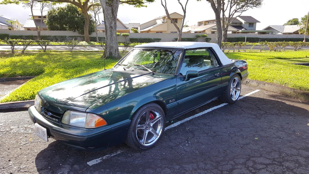

Eibach Pro kit, tokiko shocks/struts. 5 lug, 4 wheel disc conversion. Ride height is perfect for me. Never bottoms out, handles great.
