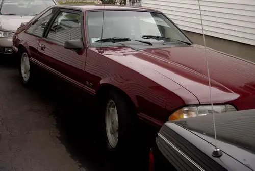

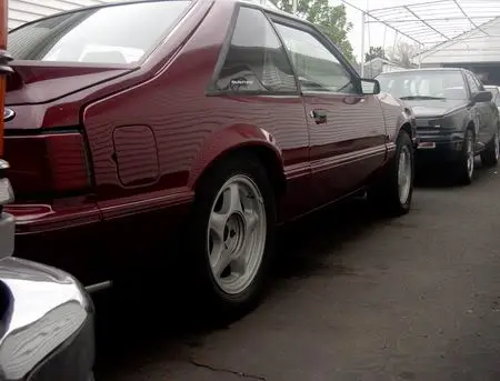

i've got lakewoods all around, and new isolators, minus the rear. eibach drag springs cut about 1- 1 1\4 coil. sits right, and launchs like a slingshot

i got the 70\30 . sorry for the pic, that was before i dropped the front. here's a quick pic.
