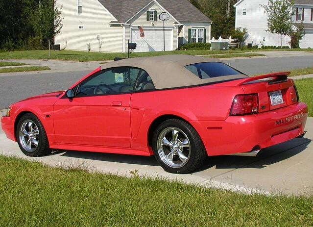

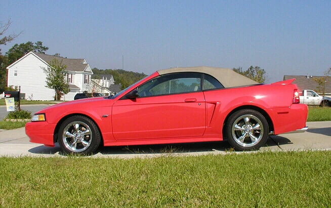

found these pics of a vert on Vogtland Sport Springs ( Red Violet Sport Springs they refer to them as in the article). looks like a really nice drop to me :nice:
