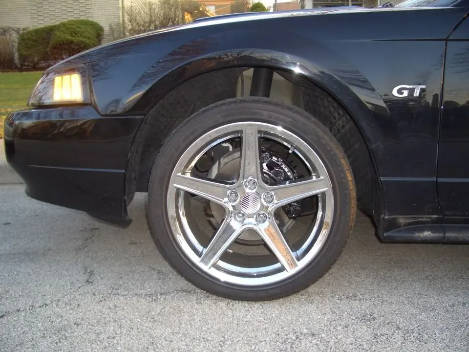

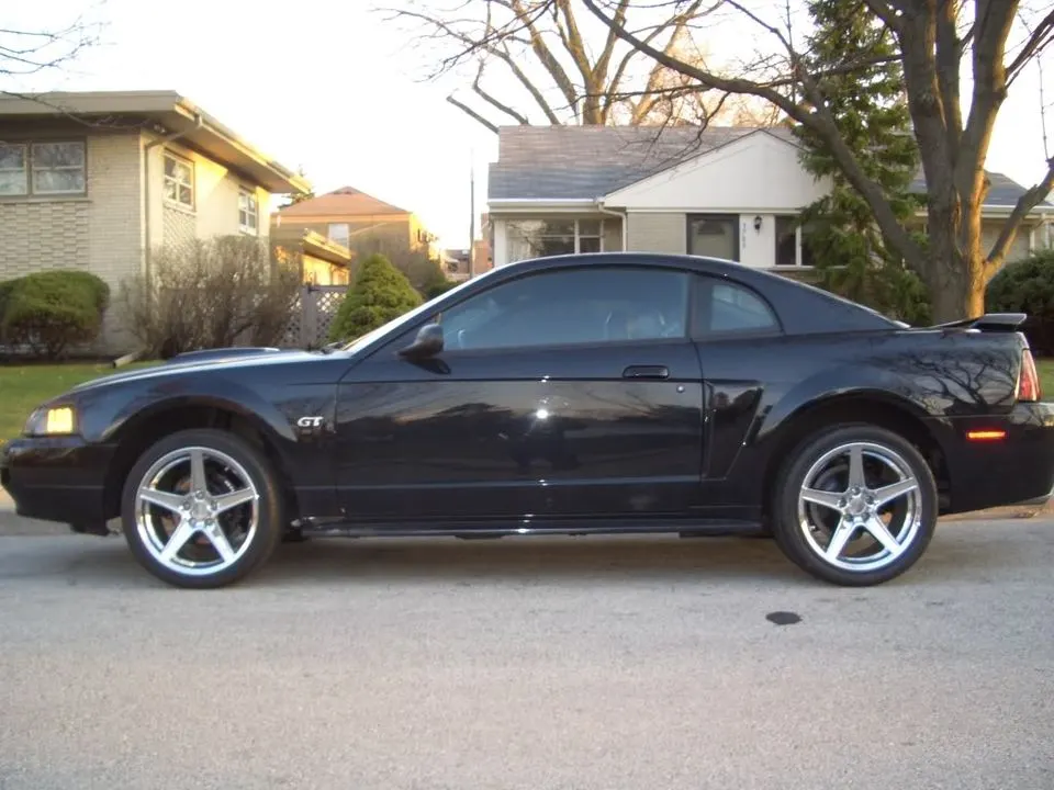

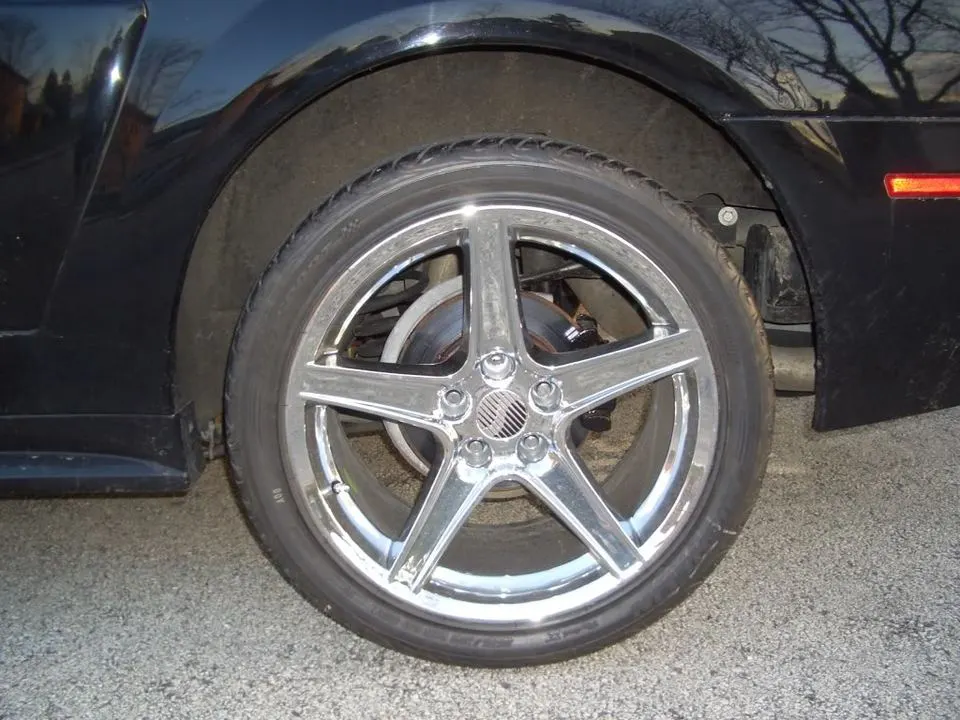

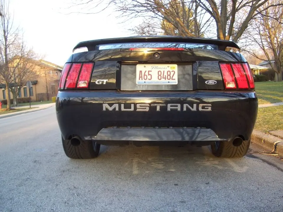

Here's what i'm working with:
**Note - the pics were taken while the car was titled, so the wheels gap is a little less then pictured.
Wow. Thats some serious 4x4. You are doing the right thing!!!:nice: H&R SS are low, but the coupe springs arent as low as the verts. The ride quality WILL suffer I'm afraid, but handling will improve dramatically. Its night and day.
With a decent drop (like the H&Rs) you should really do shocks/struts too, and possibly CC plates if you can budget it. I did them all together. If you want a smaller drop with less impact and ride and without buying anything else you could try Steeda springs, but they only drop about an inch or so.
