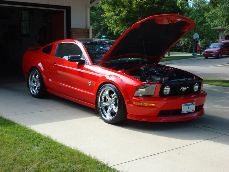

Here is my stang, Steeda Dampers, Steeda Sport Springs, Steeda GT500 rear sway bar, and 1.25" wheel spacers in the back until I can get some 18x10 Deep Dish wheels.

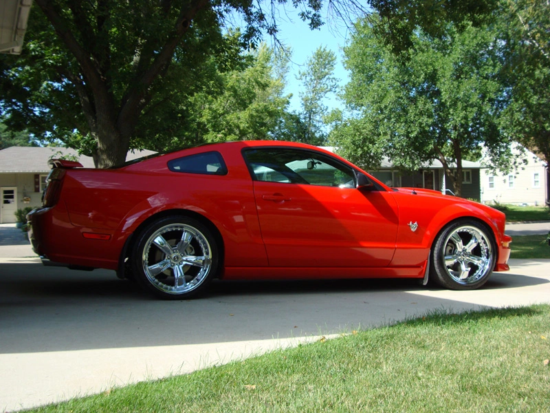

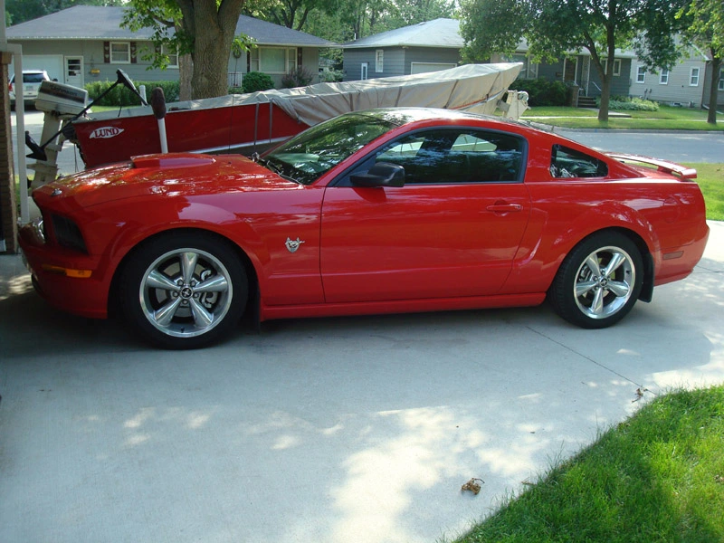

I'm currently running just StangSuspension springs (1.75" front/1.5" rear) on stock dampers. Using Steeda's HD upper strut mounts/adj camber plates and I've swapped out the rear LCAs for J&M and have a Steeda adj panhard bar (will be upgrading to BMR). I'll be getting a set of the FRPP dampers very soon and I'm thinking of getting the matching K Springs to go with them and ditch the current springs. I hate the fact that it will raise the front a little, BUT they will be a matched set AND I won't scrape nearly as often as I do now
Here are some pics of the above mentioned suspension setup on both the OEM 18" tires/wheels and staggered 18" setups.

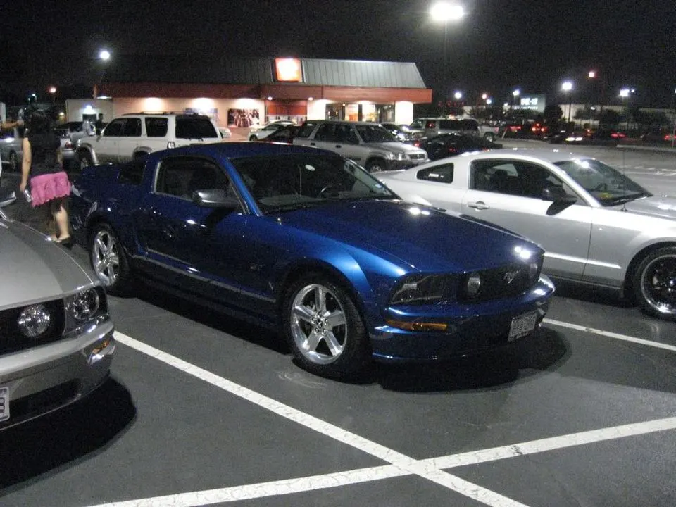

I'm currently not running these wheels (which are for sale) but the front are 255/45X18 and the rear are 285/40X18. Suspension work done: Vogtland springs, Koni adjustable shocks, Eibach front and rear sway bars, BMR lower control arms, Techco Watt's link, Prothane motor mounts, CHE k-member brace with torque limiters and Coast 4 inch aluminum driveshaft. The car handles well!

sure thing, here are few from today while I was out running errands.
You have the steeda sport springs which give a 1" drop correct?
Was anything else done to make it lower?
Because that ride height looks perfect and I may consider getting the steedas..

Thanks man. Yup, these are the Steeda Sport Springs. I think the ride height reduction is 1.25" rear, and 1" front. I have had them on for about two months now, so I am guessing they have settled. I went with the Steeda's for performance reasons. Steeda, FRPP, and Roush are probably the top three suspension kits, performance wise. Of those three, Steeda is the least costly, so it was a no brainer. And I have to say, the ride is great, I'd love to drive an FRPP and Roush mustang to compare, but having not done that, I am in love with my Steeda suspension and think its the best of all three.
